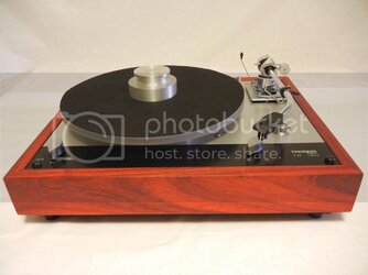

I know this is about digital audio, but this is the staple of my setup. My custom Thorens TD-160. I can safely say that this and my Marantz 170dc will NEVER leave my collection. The one caveat to the SME arm and SAE cartridge combo is that the SME is too low mass for the cartridge. So I did two things to mitigate this. I took a piece of super soft sorbothane from McMaster Carr and a Technics 4g headshell weight and tacked them onto the top of the SME headshell. Next I took a piece of super strong double sided tape w/ fiber glass for extra strength and mounted a quarter to the back of the SME's counterweight. Effectively it added about 10 grams to the arm's mass, making it a far better match with the SAE1000E. I typically use my Turntable for reference testing as it really does sound quite a bit better than my digital setup.
