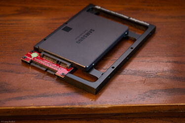

Since I retired the R410 from router duty, I had two Samsung 840 Evo drives laying around. I could have sold them, but they don't go for a ton. Instead, I ordered some very nice 2.5" to 3.5" backplane compatible (this is important) converters. The drive bolts into the connector, and the converter bolts right into the stock sled, which goes into the SAS expander. They work slick. Compared to other products out there, these for 12.50 shipped is a great deal. They are Newertech AdaptaDrive converters. Solid aluminum and built well.

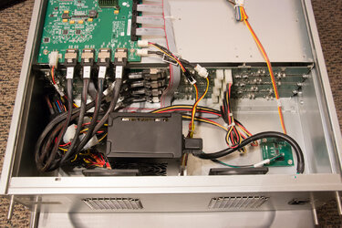

Since I got my Rackable Systems SAS expander, I've been worried about the power supply going out and leaving me without an array. The stock PSU has connectors built directly on the unit, and while they look and are standard ATX specification connectors, they are the wrong type of connector. Finding a replacement power supply is interesting, and I didn't want to be dropping big money for such a simple replacement. I've done quite a bit of rewiring computers in the past, so this one should be easy.
I picked up a Silverstone 300W ST30SF SFX form factor power supply. Using an extra unit I have laying around, I determined a full size ATX power supply won't fit without modification, and I didn't want to bother with that. However, a SFX unit barely fits without modification.

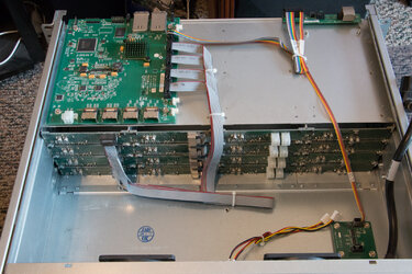

I started by disassembling the unit, removing drives, and taking all the cables out. Then, I located a spot for the PSU, found a spot to bolt it down, and made custom cables.

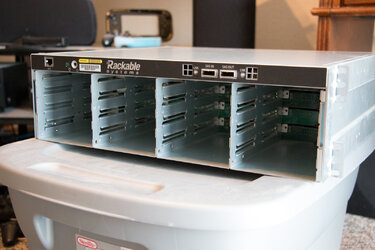

SAS unit with the drives removed and cleaned up a little bit.

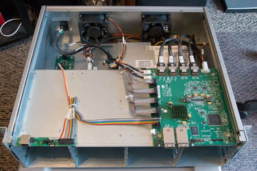

Inside of the SAS unit before any cables were removed. The stock power supply isn't bolted down because I had removed it to check a few things.
Silverstone PSU that will be installed. Completely stock.

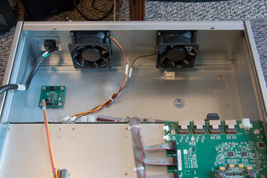

All cables removed and pushed out of the way. The tie down power got removed later.
Another view with no cables.

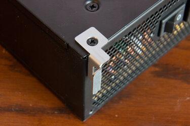

I stole one of the tie down brackets from the stock power supply, and bolted it to the stock PSU with stock screws. I was surprised the stock screws were long enough for this to work!
Power supply installed in its final location. It moves around fairly easy, but this shouldn't be an issue for a unit that never moves.

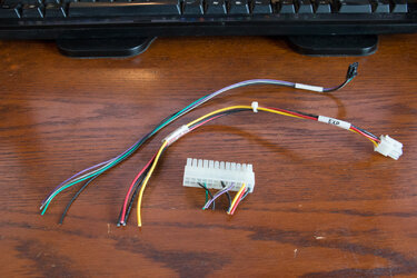

Now to start on making and converting cables. Both these cables went into a ATX connector, but I need the "male" version of this connector instead of the "female" one, so I can plug it directly into the Silverstone.

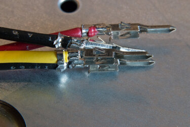

Pins installed on the cables power the SAS logic board. These pins are pretty small; had to use a macro lens to get a decent picture.
Final version of the flipped ATX 24 pin connector, which powers the SAS logic board and the power control board.

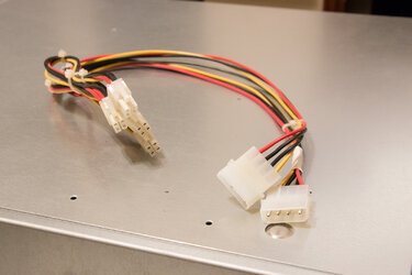

Final version of the cables which power the hard drives. The 4 pin "Molex" connectors in the bottom right used to be 4 pin Minifit Jr connectors, like the ones on the left.

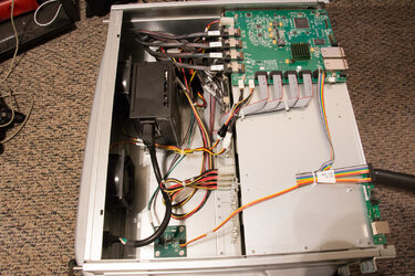

Power supply and all cables installed in the SAS unit. A little more messy, but a lot more reliable than the stock unit.
I've been using it for two months without any issue. The fan in the stock PSU unit was very loud, and could get louder when it was warm. This SAS unit with voltage drops on the back fans is very quiet while keeping the drives at a reasonable temperature.

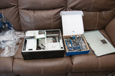

Well, I finally got the router up and routing. Effectively, anything which could have gone wrong, did. I got the case, power supply, and processor on Saturday from Austin, and it was well packaged. When I started putting the system together, I quickly realized I didn't have a heatsink for the new system. Luckily it is the same socket as the HTPC, so I decided to cannibalize it, stealing its memory and heatsink. OK, crisis averted.
I assembled the system, making the wiring all neat and hidden. It looked good and took me a bit of time. Fired up the system, and there is a loud noise which sounds like something hitting a fan. I look the system over and find out the noise is from the power supply. Crap, ok, time to rip the whole thing apart and figure out what is wrong. The box it was shipped in was dropped so hard it bent the bottom of the case slightly and bent a component far enough it was touching the fan. I located the part in the power supply clipping the fan and was able to push it back slightly. The part was on the mains side of power supply, and I made sure it wasn't touching anything around it. Firing up the power supply outside the case showed my fix worked, yay.

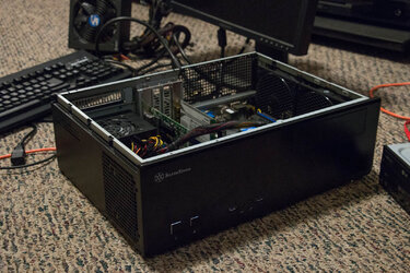

Around 3am this morning, I got everything running. Have some poorly taken photos way after my bed time:
Picture of the guts, without the support brackets installed, which hides nearly everything.
