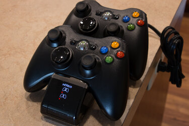

2x wireless Xbox 360 controllers with charging base
Wireless base for the controllers

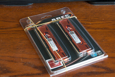

GSkill Ares 8gb DDR3

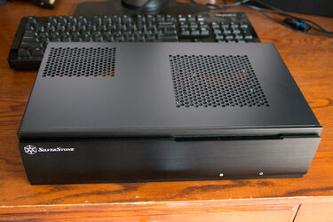

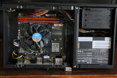

I wasn't expecting a lot from this case given the price, but it is well designed. Since it doesn't take full size ATX power supplies, I was hesitant to purchase this one, but Austin (atminside) forced my hand; what a jerk. It has space for a 120mm fan up top and two 80mm on the side, which is a lot of airflow for something this low power. The case has a good heft to it and is solidly built.

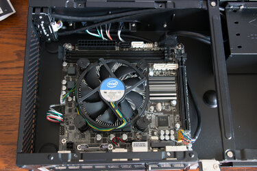

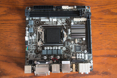

I can't express how small this board is. I've always built ATX/EATX systems, so it is absolutely tiny.
attachment.php
The heatsink with that processor is also tiny. The ports on the back are taller than it.

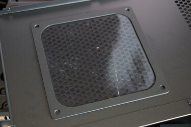

They include a filter, which I initially thought screwed in with the fan, which would be a pain in the butt to clean. I quickly realized that it is magnetic and it sticks to the lid of the case. Small features like this impress me. Never would have thought to install a filter like that.
