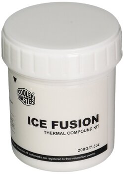

So next up I have some Thermal Grizzly aeronaut and some mx-4 to test. I also have some Cooler Master ice fusion and some paste that came with my Scythe cooler. I only had enough AS5 left for one mount so I just put that on order as well.
