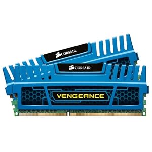

I think I could go w/ the LED fan on the side - that's the side facing my desk, so it'll be pretty nice.
I also have a question about color scheme.
Components:
Black NZXT Phantom
MSI 870-G45
Corsair Vengeance, Blue
Nvidia GeForce GTX 550Ti
What color LEDs do you think I should go with? I'm thinking blue on the top (included), green side fan, and then green LEDs inside the case (the light strip). Thoughts?
Also, can you recommend good 140mm case fans? I really like the Be Quiet 140mm fan, but it doesn't ship to the U.S. and no one on eBay sells it for a somewhat-reasonable price. I think I'd like a pretty discreet, non-LED, black (which is why the NZXT FN doesn't work :/ ), high airflow (around 60/66 CFM) and low noise (preferably 20dBA to 28dBA). I'm also wondering what a "dBA" really amounts to? Is 25dBA pretty much silent? What does 30dBA or 40dBA sound like?
Thanks.
