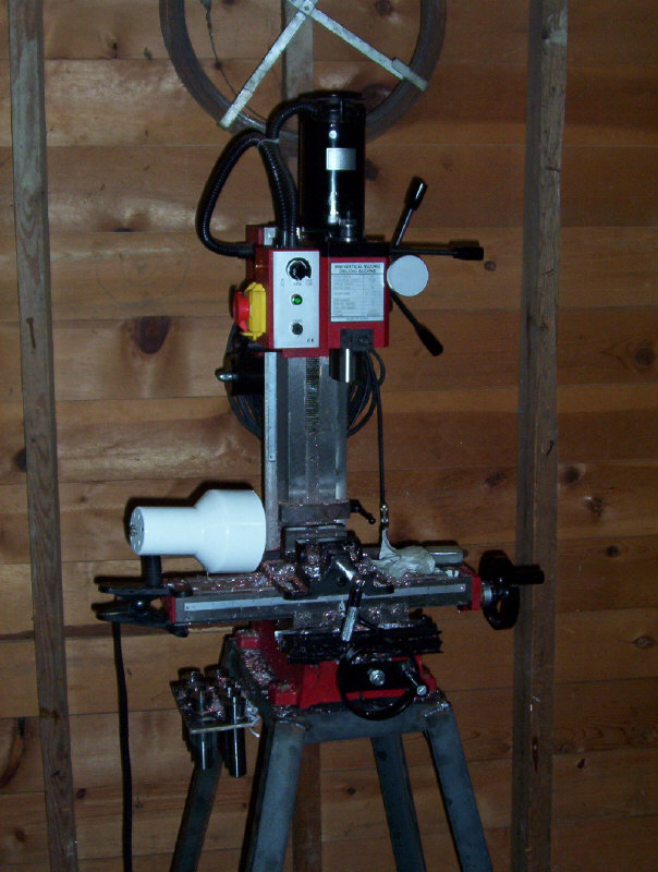

I have a seig mill, same as grizzly and the harbor freight mill, but from homier.com, I highly suggest that one over the others. Youll spend about $500 after shipping, plus another couple hundred on tooling. get a good collet set for $50, a good vice(I wish i would have to start with) for $100 at grizzly.com 4" vice is good for that mill. then youll spend probably $50 on end mills. spend some on a stand for the mill, some on oil and grease for doing all the sliding parts and whatnots, and a lot of time.
It took a good chunk of time to get the mill close to optimal, I still got a ways to go to get it going perfectly.
I like it a lot, If I could have done it different and had money, I woudl have bought a bridgeport. but I really couldnt for where I live. where my mill hasta be, In my basement. Theres no other mill I could put down there except a cheaper one.(dumb choice)
I would get your end mills at jtsmachine.com, i have a direct link to nice carbides at home. I got my collet set off of ebay for $45 or so, and made the stand and collet holder.
heres some eyecandy

On my mini mill, I use an old P3, running turbocnc(dakeng.com) as the controller. I use stepper motors on the Griz(305 oz-in hybrids), powered by 3 -Gecko G201 microstep drives(2000steps per rev.)running @18Vdc/4.5A each.
the drives , PS, and breakout board(connects the parallel port of the controller to the drives' correct pinout)are installed in an old server case I was given.
Taking some NC classes is a big plus I guess. But not necessary.

@ Neomoses....My last conversion was a RongFu45....servos of course. Great mill and a good recommendation,but not exactly cheap for the average hobbiest.
I still say that a small mill is the best investment for someone who wants to start out. And my Grizzly may have only cost me $500, but it is a very accurate POS......maybe I just lucked up and got one that was shipped out when the little 93 Yr. old lady thats usually on QC, was on her day off!

I did take apart my mill a little after I got it, I wasnt sure of what to do, worried I would screw something up, it was a few days, only used it once.
I did grease it and all that good stuff.
those delrin gibs, did you make those or buy those?
Im not sure if anything is warped, but Im gonna take it apart one of these next few days, and clean it up. check for warped stuff.
any thigns I should look at carefully?
oh the binding seems like its in 1 spot on each turn. and its more when i go fast than slow. Its almost like its just the little scale on the wheel thats binding, because that thing changes, gets pushed. so I made a mark where zero is on it, on the wheel.(back of my vice)
I dont have any money to spend on it, so I dont know what Ill do if I need to buy anything. do you have any pictures or anything of yours? I have wanted to see it ever cince I heard you talking about it.
what did you do about the Z axis? Mine isnt very acurate at all. I have to hold up the 3 pronged drillpress style wheel to get it pretty acurate, sometimes it doesnt lower when I tell it to, and sometimes it lowers more... If I dont hold it up, it seems like itll drop and stuff. any suggestions on that?
