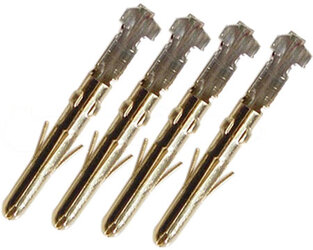

Take the pen. Disassemble it down to the ink. Now, cut off the tip (the nib, the part you write with). And, if necassary, the back end (there might be a thing blocking the tube at the back of the tube). When the ink starts to flow out, hold the ink tube under HOT water (get tweezers if needed) and watch the ink drop out of the tube...
Once it starts to clear up, and no more ink falls out of the tube, you will need to do the tricky part... What I did was take a tissue, and then from the corner, twist it up so the tissue gets REALLY small. I then stuck it in the tube, twisting as it goes in the tube.. then pull it out, and repeat until around 3/4" of the tube has absolutely NO ink in it. You will be able to see through the tube, only 3/4" is needed to be clear. The remaining "ink" is just caked onto the sides of the tube and won't flow out. Here is a pic of how to twist a tissue to slip in the tube:
http://www.bostonrinkrats.com/solidx...tubefemale.jpg
Then, fully cleared tubes look like this:
http://www.bostonrinkrats.com/solidx...leanedtube.jpg
Now that the tube is cleared of ink, the easy part comes:
(MALE CONNECTOR)
You are already done =P. Stick an open end of the tube into a male plug in the y-splitter. Twist it around a bit, and then pull on the wire. It should come out with a little force. Sometimes the tube won't fit all the way into the molex, so you might need to get another, smaller, ink tube (I use a small tube for the male, and a large tube for the female). Now, take the paper clip, straighten it enough to fit in the tube, and push the paper clip into the pin until the pin slides out.
(FEMALE CONNECTOR)
Here is a weird part. Get the razor blade. Now, like most tutorials/guides you may have read about the "pen trick" molex remover, it says to cut the tube... WRONG!
What you want to do is make the inside of the tube bigger in diameter. Which in turn makes the tubing "thinner". Take the OTHER side of the male pin remover, and insert a sharp corner of the razor blade inside the tube...
Now, twist the razor around in circles, so it shaves a bit off of the tubing. It probably won't be that visible, but it will shave off the tubing a bit...
Occasionally, after a few twists of the razor blade, pull out the razor, and try to see if the tube will fit around the female pin. If it is really hard to get around the pin, but if it does slip over the pin, push the tube all the way in, and then pull out the corresponding wire (this will require a firm tug of the wire, it doesn't just fall out). Now, while the wire is out, stick the tube over the bare pin, and keep shaving a bit of the tube. After every few twists, stick the tube over the bare pin again. There are two "tabs" that stick up a bit. As so:
A bad ASCII drawing, but its kind of like that. When you are putting the tube over the pin, your goal is to push the tabs down. As long as the tube makes a snug fit over the pin, and it pushes the tab down, your remover is working (the reason I am against making a "slit" in the end of the ink-tube is because the tube eventually seperates and doesn't push the tabs down, thus making the pins impossible to remove). Now, to remove the pin, get a paperclip, straighten it, and push the pin out... the paper clip might have to be pretty long, it goes ALL the way into the pin (almost to the back of the molex). Also, to shave off inner diameter of tubing, you can get a small drill bit, and twist it by HAND.
Some pens have a thick outer diameter, so you may need to shave that down. My latest female remover had a thick tube, so I got some 150grit sandpaper and sanded the end of the tube down:
http://www.bostonrinkrats.com/solidx...eddowntube.jpg
Well, theres a free Molex Pin-Remover, Female and Male, ALL in a 4" pen ink-tube... Double-sided molex removal goodness =P

ATX, P4, AUX, Floppy, Fan and S-ATA Connectors
Okay this gets annoying, but its well worth it (for me)...
Well, first, get the spare floppy disc. You see the sliding metal part? Rip it off... You can slide it, and slip your finger under it, or something like that, just rip it off some way or another without warping it too much...
Now, here comes the hardest part... Cut off two thin pieces of the metal that you just ripped off with some scissors... Careful, this metal is sharp... Now, get the ATX connector, and then see if the metal fits... the little pieces have to be THIN to fit within the ATX connector... anyway, get the two pieces, and try to stick them to the SIDE of the ATX pin (the pins are square, and the left and right side each have a tab to push down, like the Molex 4-Pin pins)... Like, take one metal piece, and try to slide it in the right side of the pin, then take the other piece, and slide it in the opposite side... the metal piece has to be big enough to fit ALL the way down into the pin housing... Be VERY gentle with the metal pieces, they bend VERY easily, and when they get bent, they are hard to insert in the pins... If the metal strips are difficult to get inside the connector, see if they are bent or are too thick to get it (they have to be EXTREMELY thin at the end)... The housing of these connectors seem to get smaller the farther in you look at 'em...
Once you get both pieces of metal inside the pin housing, see if you can pull the wire out of the housing... It should take a strong pull, but not too strong... If it doesn't come out, try taking out both pieces of metal, and SLIGHTLY (can't stress that enough) bending them inwards, so it will depress the pin's tab better... Keep doing that until you can remove the pin...
Now that the pin is removed, bend the tabs up more again (they will be close to the pin)... You can use a fingernail, or a razor, something that can fit in between the tab and pin...
Place the pin back in the connector, and remove the metal pieces... Now, take the two metal pieces and hotglue them together... I would NOT reccommend tape, but if need be, use it... When gluing the connectors, DON'T glue them close together... Glue them a little narrowly spaced than the normal ATX pin... This way, when you insert the remover, it will have a little 'spring-action' and depress the tabs on the pin easier... Also, if you want this to be a universal remover, get the thin paper-clip, and cut off a small section of it... Glue it to the two metal pieces...
Finished product:

howzabouta up close molex pin pic?
