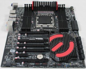

FRONTPAGE EVGA X79 Dark Motherboard Review
Excellent review - actually made me want to go out and get one. Does look good too - even the BIOS screenshots. Too bad about the fan controls - Maybe EVGA is thinking that people will be using hardware fan controllers?
The price seems about right too. Mircocenter even has it $380.00 when bundled.
There is an item I completely forgot to mention in the review. It probably won't affect many of the people reading our site, but it is an important omission by EVGA none-the-less.
At bone stock, this board is not capable of running the Intel specified turbo multipliers on a per-core basis. When you leave everything at auto, with C-state reporting, EIST and Turbo all enabled, the Dark will stick you with a 37x multiplier, or 3700 MHz, on all cores. It doesn't boost to 38x, 39x or 40x for more lightly threaded loads. Thus, your single threaded performance from a completely stock perspective is going to take a 300 MHz hit.
Most people won't buy a $400 motherboard & $600 CPU to leave it at stock, but it's a definite deficiency that EVGA hasn't been able to fix this issue with multiple BIOS releases so far. The BIOS stability from an overclocker's perspective is so much better than it used to be I just forgot about this problem.
Thus, if you're buying an Ivy Bridge-E platform and are concerned about stock turbo operation, you probably want to look for a different board than the X79 Dark at this juncture. Hopefully they'll introduce proper stock operation later. Then again, if you're going to operate at bone stock, why on earth are you looking at spending a minimum $1,000 on an enthusiast platform to begin with?
HUGE thanks to Ian Cutress over at Anandtech for pointing this error out. If he hadn't asked about it, I never would have remembered I had this problem testing at stock. Kudos for the backup!
EDIT - I'm told this will be fixed in the next BIOS release. I'll be sure to test it out and report back. :thup:
UPDATE 10/5/2013
I'm happy to report the new BIOS fixes the stock turbo issue, so that's all set. :thup:
The beta is uploaded to our servers and you can download it here. Remember, it's a BETA and you use it at your own risk.
