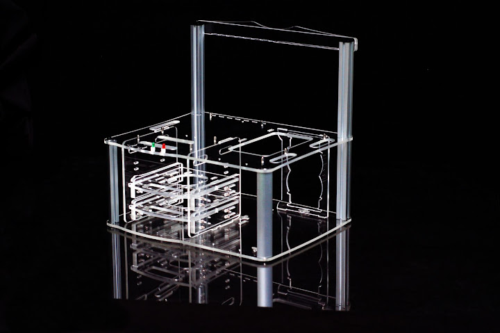

Fully assembled
Fully assembled

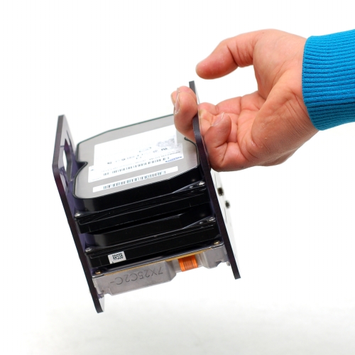

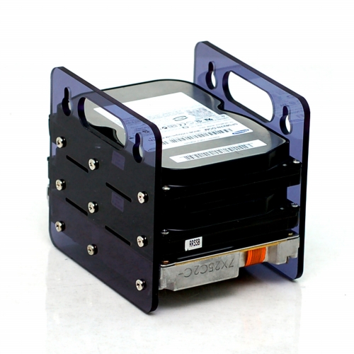

I like the sliding locks for the drive cages and add-on cards (PCI, PCI-e) because they are quick, easy to use, and tool-less.  They keep the parts locked in snugly and don’t come unlocked when they’re not supposed to.  The only down side to the drive cages themselves is changing physical drives is a little tedious because the drives are screwed in with regular screws.  Adding to that, both sides of the drives need to be screwed in to the drive cage since they are two pieces of Acrylic that are not connected by any other means.  This wasn’t a big deal for me, though, because I devote one hard drive to benching and don’t have a need to swap it out.  The same issue is present with optical drives, but, again, I devote one DVD drive to my benching rig and don’t have a need to swap it out.

There are several cut-outs in the motherboard panel for routing wires.  There is even a handle and yes, it is possible to carry the benching station around, fully outfitted, by the handle with only one hand.  Though, you might not feel too confident doing that since you will see parts move when it is picked up.  The only cut out that is missing is a proper hole for changing the backplate of the CPU heatsink.  There are two holes that are close but neither would allow proper access on an AMD 890fx board and a Intel P55 board.  That will be a problem if you happen to change your heatsink often since you’ll have to remove the entire motherboard to do so.  Another thing missing is for some way to mount more fans and direct them at crucial components.  Making your own mounts or dangling fans isn’t that hard to do but does add clutter.
The drives are tucked neatly away below the motherboard

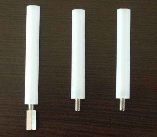

    The hand screws are intended to use small fans, e.g. 40mm or less because only one side(hole) can be screwed.

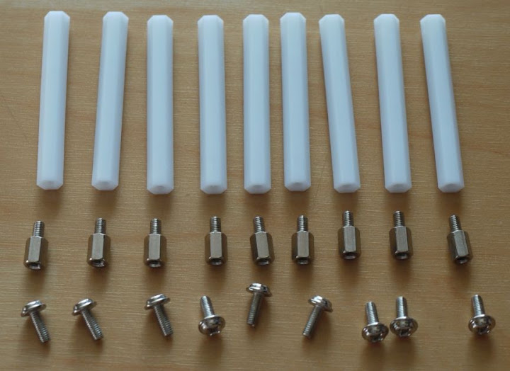

    Practically, if more height is needed or you want to use it with other than motherboards, we have hand screws which have both male and female screws as shown in the below picture. By adding this one, the hight is lengthen.
    Bobnova,
    We are selling this hand screw set as an accessory in Korea and Japan.
    One set of hand screws consists of 9 pieces of spacer, handscrew and normal screw as follows:

    Ed, looking at them and judging by what he said, they are big so its easy to twist them onto screws/standofss by hand.
    It also sounds like you could mount your board directly to the standoff, screw it down with the handscrews, then mount a fan on the handscrews blowing down onto your board.
    The white long plastic things have female thread on both ends so you cannot use it for screwing anything tight or loose, I;'m a bit puzzled at what it is used for?

    Cool thanks! Aren't those white screws just tool-less screws and not long standoffs, or are they both?

    There are two reasons why the hand screws (= white screws) are longer than expected.
    First, to ease when fastening and loosen the hand screws. The longer the hand screws are, the easier and safer it is to use them. We would like to call it ergonomic design. :)
    Second, you can attach additional fans on top of the hand screws to cool the spot of motherboard under it. In this case, the length of hand screws keep fans apart from parts on the motherboard.
    Anyway, hand screws enable a user to swap even motherboards for testing easily without screw drivers! I think motherboard hand screws are one of must-have items for computer geeks.

    That is correct, the white standoffs is about two inhces and screws on top of the board, according to the instructions that is, does not make sense, I will cut them back to about a 1/4 inch
