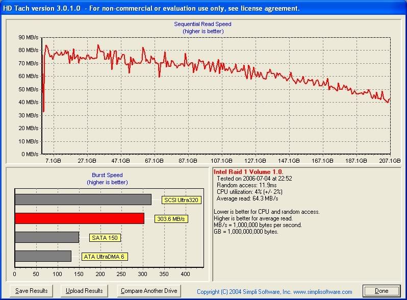

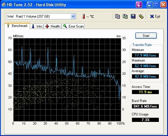

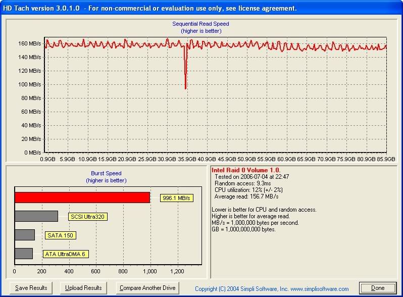

    Hi ! My 1st post here, sharing result on my 7200.10 Seagate perpendicular drive.
    Software onboard raid using Intel Matrix Raid on two 7200.10 250GB which are two volumes at two physical disks -> Raid 0=80 G (boot/system drive) + Raid 1=192G (data drive).
    Both disk's jumpers are disconnected to enable 3Gb transfer speed, it was connected (force to 1.5 GB) by factory default.
    So far the noise and heat performance is excellent compared to my past experience with 7200.9 & 7200.7 family.
    These are the results using two popular benchmark softwares :
    Raid 0 , avg. seek is good since it is on narrow short stroked area, and burst speed is fast ! Yes, though it was from the cache, not mechanical but it beats SCSI Ultra 320.
    This volume is designated for fast loader such as OS, programs & virtual memory. Found this is the best combination thru lot of pains (reformat, resizing & OS installs). The front faster region of the disk is perfect this purpose and also the burst speed is started to degrade above 100GB region. Ghost/disk image on the fresh installed OS captured for future recovery just in case !
    Raid 1, not bad considered only for data
    Raid 0
    Raid 1

    Yes, the burst transfer is reaching 1 GB/sec and the linear transfer speed is almost constant 160MB/sec from 0 to 80 GB/end of the volume.

    oh its intels matrix raid... not the old stuf... that is just FREAKIN AMAZING... FREAKIN AMAZING.... i mean 1GB/s burst... 160MB/s sequential... thats WAY better than some raptors ... and the price per gig is WAY less ... i cant imagine 4 of these drives with this matrix raid stuff.
    heck even that random access time is close to raptors of about 7.7ms

    @bing.. your first HD tach is only displaying the first 86GB or so of your array, any way you could do a screenshot of the full array?

    Quote Originally Posted by greenmaji
    I think that IS the "Full Array". The 2 HD's are freely configured in the Intel Matrix Software. The front part of the HD's are set up as a "Partition" running in RAID-0. The second "Partition" is the RAID-1 array.
    I might be 100% wrong - but that is how I understand it. RAID-0 AND RAID-1 on the same 2 HD's simultaneously! Another "WOW" for Intel Matrix RAID

    Quote Originally Posted by Randyman...
    AHHHH I think your right other then the CPU usage for the Raid0 (heck those scores in the raid0 almost make the CPU usage worth it)
    I wonder what the average write is?
