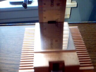

i wouldnt go that high also. look at my results using only
600 grit sandpaper and using the patented "Hoot" technique.

Thanks a lot. :) Where can I find this "Hoot technique?" :)
Going to start elbow greasing it in a couple hours. :)

Thanks, KK...on both threads. I'm settling for the 600 look, just as soon as it looks like Starfox and Hoot's. :)
