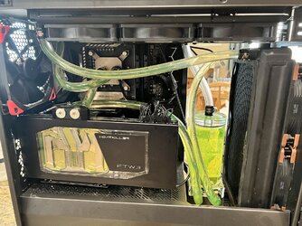

3080Ti FTW3 into the custom loop

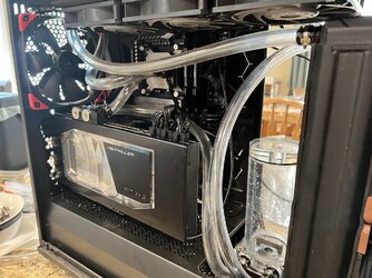

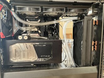

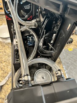

Mine is a Primochill Enhanced. I'll swap PWM headers for the pump to see if I can get the PWM working again.
System is plumbed, leak testing and doing the radiator dance now. I hooked the top fill plug to the fill port on the case to assist with the dance. Glad I did, never knew it would come in so handy.
For the record: Tygon is obsolete, or at least not as good as newer tubing. Get that fancy flexy stuff from Performance PCs or whatever. Way more flex than the classic R3603 or whatever the part number was.
If she fires up again and plays nice, I think this is going to work rather nicely. The flow rate from the pump is quite adequate, by the way.
Woomack, with just my thin 280mm radiator and the 1200rpm fans, my 9900KS will top out around 85-90C on Prime95, putting me 10-15C away from throttling on AVX loads, which is about 250W. I'm also running bare-die which helps a lot. Not sure how well it would work on something like a lidded 12900KS, though. Might be more challenging.

Very nicely done Rufus! I got my FC block yesterday Linky , and hopefully get the new alphacool rad tomorrow. Ran out of tubing last time I updated and forgot to get some. Gonna be a few days before I add the video card to my loop.

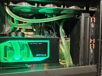

Rig is up and running. Got my fan speeds pretty well dialed.
House: 72F/22C
Running Heaven demo:
GPU: 55C
GPU power: 375W
GPU clocks on stock curve: 1950-1980MHz
CPU power: 60-100W
Water temp: 40C :D
I call this a win! I don't see a point to going full torture test with Furmark and Prime 95 simultaneously as it's not a real life load for me. I think I've got some OC headroom on the GPU with these temps.....

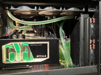

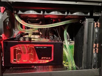

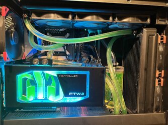

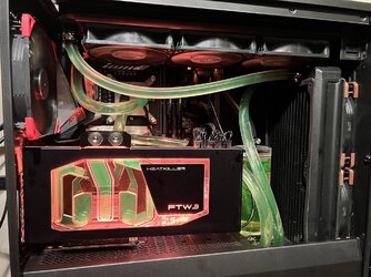

LED's are bright on this thing! Looks pretty good with orange in the right light. Some colors show off the coolant nicely but the contrast is a bit funky.
The cell phone camera makes it look weird. Much prettier with real eyes.

Blue-green usually looks good as green reacts in blue light. Even though it's not marked as UV then you see it looks like glowing.
Cell phone cameras have problems with light and a lot depends on angles and ambient light. I have the same problems when there is no white light in the background.
