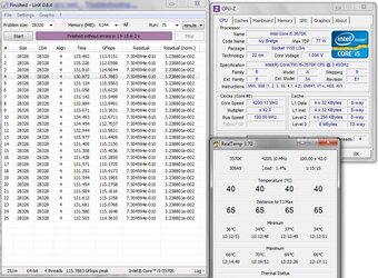

Hello,
i've just changed my old q9550 to 3570k, Asus P8Z77-V, Corsair Vengeance LP 2x4GB 1600MHz. I've read some ib oc guides and i'm not sure i did it right. From what i read for 4.2Ghz i should have vcore around 1.2, and now i have it set at 1.040 and running LinX with AVX (jumping between 1.040 and 1.048). Previously completed LinX at 1.050 (jumping between 1.048 and 1.056) without errors, though i only tested it for 1h15mins. Changes i made in bios before i started oc:
Ai Overclock Tuner: X.M.P
Turbo ratio: 42
Internal PLL Voltage: Disabled
Spread Spectrum: Disabled
LLC: i left it on Auto
Should i make any changes to bios settings? I think i need to test with other programs or oc'ing went wrong and it didn't really oc, though cpu-z and realtemp are showing 4200Mhz. Which programs should i use and how should i test it to check if it is really stable without running one test for over 8hrs?

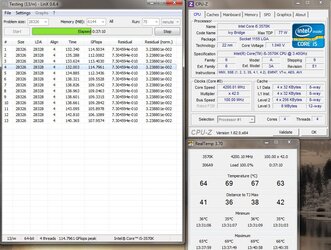

Also i think temperatures for such low vcore are a bit high, i'm using Thermalright HR-02, and zalman stg2 paste. I've tried reapplying stg but temp only decreased about 1-2°C. For currently running test (in Lynx) max temp was 69°C, for 1.080 was 72°C for 1.104 73°C. Is there anything in bios settings that can cause increased temperatures?
1.050:
1.040:
Sorry for such noobish thread :)

What voltage is CPUz saying under load?
For current 1.040 - mostly at 1.040 and jumping from time to time for a second to 1.048. In first post second ss is under load when linx is running.
Pictures are blocked for me at the office unless they are hosted internally at the site... All I see (now) are "." (periods).
Every chip is different. I need 1.2v at 4.5Ghz (which is better than most?). So I would assume I need 1.1 or less around that area. Seems like you have a solid chip is all...assuming its actually stable. :)

Thanks for answers, i'm running currently Large FFT, will run small after - if this one finishes succesfully. I hope i won't get any errors :)
