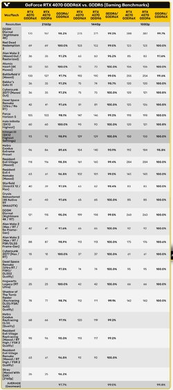

A test is out for a GDDR6 model. WCCF did the testing, but their presentation really needs work. Videocardz tried to put it in a more digestible table. Average perf drop at 1080p, 1440p, 4k were 0.2%, 1.0% and 2.3% respectively.
Looking at the detail raises some interesting questions. As mentioned before, if something were purely bandwidth scaling, we could expect up to 5% drop. Metro Exodus saw drops of 4%, 9%, 10%, but not when RT was used. I'd treat this as an outlier and it should have further investigation to check repeatability. There are a couple other individual points around 5% but generally it is less. I suspect this is run to run variation. I'm not familiar with how WCCF test.
I think it would be more interesting to see a median value as that would resist outliers better. I would use Videocardz table but they seem to have implemented some anti-copy to their site and I'm not motivated enough to get around that. In the past text is still easily extractable from source, but I'm not sure it would go so well for a table.

I can't copy the text without digging into the code, but I can take a simple screenshot.
Which then needs to be fed into OCR to extract the numbers, and formatting and values need to be checked. More than I'm motivated to go through right now. If it wasn't protected, it would be a simple copy paste into a spreadsheet and I'm done already.
