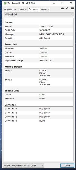

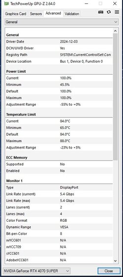

Even so, using GPUZ it shows 220watt. What i find odd, is when playing games. Newest one being Hogwarts legacy or God of War, it hits 2.7ghz, vref 1.1v, board power 120watt to 140watt. That is not even near the 220watt they are showing, wtf is going on? It is not even running at what PNY is showing for gpu speeds. I am at a clear loss as to why it is running this way. I wonder if it has to do with changes made in MSI afterburner getting "saved" some how and using that. I wonder if it is pulling from the curve editor even though i did not change any thing. I wonder if it still gets used/saved, when all i wanted was to lower the power%

Even went looking to make sure the bios was not swapped.
everything in GPUZ matches up the bios specs on that page. I am at a loss what the card is doing on its own. i still want to know why it is not doing the lower speed. how is it going to 2.7ghz with vref 1.1v automatically.

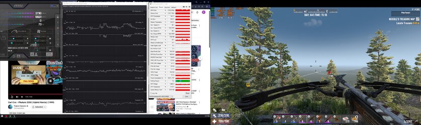

ok, take a look at this. You are seeing correctly, i set the power limit to 60% and it is still hitting 2.7ghz. Maybe i should go into save mode, uninstall MSI AB and drivers. then just install the drivers and see what GPUz shows. these fans are killing me, get to 50% and i can hear them in my closed back head phones. Granted the PC is next to me about 2ft away. Now if the temps are that high with the case cover off, i can only image if i put it on. Now the thermostat in the hallway reads 77F, i think it is hotter then that in my room.

if the power usage is that low, why is it still running hot?
Because the cooler is too small. There was a thread at TPU about the dual fan cards being hot. Just how they are.
