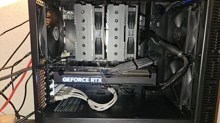

so i killed the PNY 4070S, was safe removing the HSF but clearly not safe enough! Well hopefully it can be fixed BUT i couldn't wait and got a new one. This time it is a HP card, dont want to hear it! It was a good deal, 1in longer then the other one and has a much better hsf setup. no tweaking at all in Hogwarts some places it hits 210TDP and gpu core speed around 2.7ghz. in 7 days to die, its got a huge graphics over haul, the TDP ranges from 180 to 202 and the core clock is always between 2790mhz to 2804mhz. Even at those speeds and TPD main gpu temp never gets over 82c hotspots around 90c, thats on the hot end. Normally sits around 78c with hotspots in the mid- high 80's.
Best build i have ever done! all thanks to M.2 drives! lol, no way i would ever get this clean of a install with sata drives, ect.
