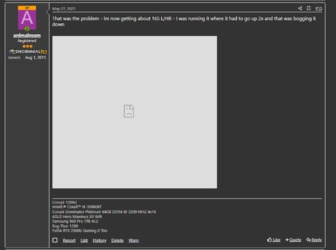

I haven't had my morning caffeine, but I need help understanding the issue here... are you saying the PCIe ribbon cable for the vertical mount was pinched somehow, previously? How is it not straight if you screw the IO into the rear? It's a flexible ribbon. The images (again, please attach these to the forum, not 3rd party links!!!) don't show me much?
Is the problem the IO plate sticking past the expansion slots in the new position? I wouldn't do anything. It is what it is if it's pinching the cable somehow in a different position. Doesn't EK give you a double-wide IO plate with the block? You can always cut it off but...................why? It's not a showcase type of case...
Just to show you what happens if images aren't hosted here...
