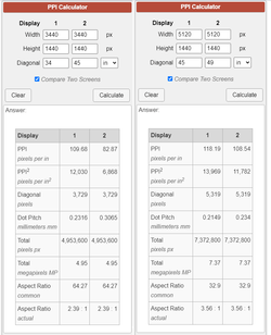

Could anyone expalin me why 45'' OLED monitors, have poor resolution?
What do I mean by asking that, is a fact that pixel density is very bad, because most of them have 3440x1440 resolution.
I did few Calculations and it seems, that pixel density is around 45% lower when we compare it to 49'' 5120x1440
5120x1440 on 49'' => PPI2 = 11,782
3440x1440 on 45'' => PPI2 = 6,868

Also, the pixel density between 3440/5120 x 1440 us like 40% more when looking at your screenshots and the 45" example (118 vs 82 ppi = ~36 ppi difference. 36/82 = ~44% increase in ppi.... or did you mean ppi there and not %??
Edit: I see what youre saying, ppi2... I dont even understand the relevance there versus ppi, lol

PPI is simply a function of number of pixels in a space. The answer to why it's better or worse is in the math.
If you want better PPI, get a monitor with higher resolution in the same size. Or a smaller monitor with the same resolution.

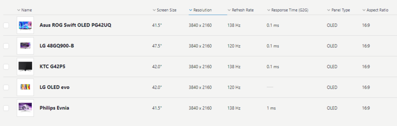

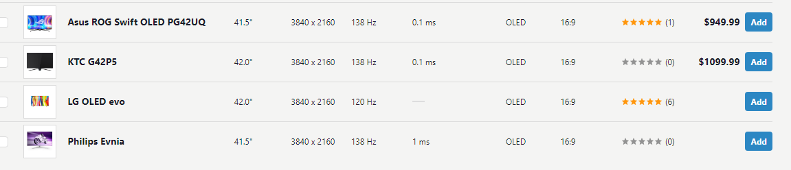

Yes I agree that 10ppi wont make a diffrence, but still there are no OLED monitors with 45'' and high resolution, this is what i have found but still noone of them is an ultrawide:
