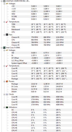

I let the ASUS motherboard do its little EZ Tune thing. I selected the Gaming and Water Cooler options. It's been perfectly stable for about 3 days of gaming and general usage in Windows 7 and Linux Mint. But when I installed HWMonitor and Prime95, I saw the temp shoot up to 100C!!! :eek:
Needless to say, I doubt many games will give 100% load to 8 threads, but still...
Here's the HW Monitor for the Prime95 run:
Any thoughts? Is VCore too high?

Now I have manually set VCore to 1.25V, per the guides I've been reading on here. However, running Small FFTs for 1 second instantly pushes the CPU temp up to 100C, with all system fans set to 100%. Running blend now pushes it to the mid 70s on the package. Is this just normal Haswell refresh behavior?
Also, the ASUS Z97 Pro has a fan port called CPU Opt, which is where the AIO Pump cable is plugged in. I couldn't find anything in the manual about that port. Is this the correct port for AIO Pump headers?

Wow, I was only looking at VID. Didn't even see the 1.8V VCore! What do I need to adjust?

Well, I just went into the BIOS and Restored Optimized Defaults. VCORE still shows 1.8V, but VID is 1.2V
Anyone else have input on which voltage is accurate? AIDA64 also showed CPU Core Voltage in the 1.2V range. Where is HWMonitor getting the VCORE number from?

Thanks guys. Any input on the VCore @ 1.8V while VID is 1.2V? Is the VID the more accurate reading?

the 1.2 is what you are after, that listed as vcore is cpu input voltage, what the board sends to the cpu that it then reduces to 1.2 and the other voltages it uses.
I have had a few cpus that I ran that as low as 1.5 and some that did not like it below 1.7.
my better chips have tended to like 1.8 on that setting.
VID, by definition, is your stock voltage. Vcore is that and anything outsode of it.
