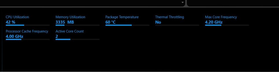

lafindumondeNF
Aug 30, 2013
When benching at 4.2 stock i get spikes up to 68C with intel extreme tuning utility. At 4.8 i'm getting spikes up to 80 but it's really all over the place. This just doesn't seem like it's being cooled properly. This is my first time building with the 7700k though so i could be wrong.

Tír na nÓg
Sep 19, 2015
80c is totally decent if not de-lidded. You are good up to the low 90's (TJ Max is 100c I think).
De-lidded and using liquid metal TIM will bet you a 10 to 20c decrease. Up to you if it is worth loosing the warranty for a couple of extra hundred MHz.
Don't expect much OC from the 1080ti. That is just the way it is now: boost overclocks the card to near it's max capability. Try +50... Mine doesn't go over 2000MHz boost, unless I push indecent voltage ([email protected]...).

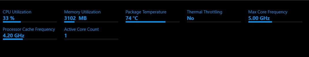

Right on! Thanks for the response. My last build was a 3770K with a 780 ti so it's been a while and things have changed. What about my fan setup? I still have an 80mm slot on the back of the case I could plug into fan2, it can't be great having the hot GPU air blowing directly into the case from the front like that without adequate fresh air coming in right? should I maybe change the GPU radiator to push out the case and then have 2 80 mm blowing in from the back of the case? What about the thermal compound, should i leave it as is or get something better?
- - - Updated - - -
Tír na nÓg
Sep 19, 2015
Bah, it will change by acouple of degrees IMO. Still worth a try though!
Ah,the good old days of Kepler. I used to overclock my last 780ti to 1400MHz+! 50%OC from ref design ;) unfortunately, those days are long gone (since 9xx).
