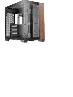

Well, I just snagged a Antec C8 Wood case off Amazon for $109...should make the perfect home for the 7950X. I'll likely only install two 360 radiators in it vs the 7800X3D gamer which has three. It will be an interesting comparison between the two if nothing else.
