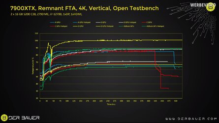

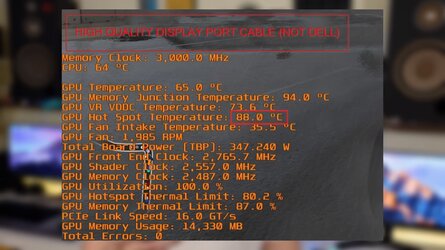

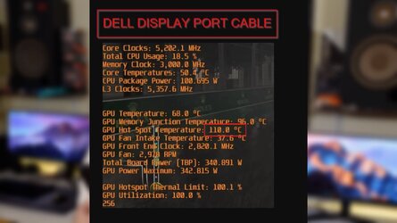

Problem is the hotspot, core never seems to go above 70c. He mounted them in different positions and even "tipped" them while stress testing, vertical seems ok-ish until tipped, then goes 110c in a couple of minutes, horizontal is hot from the start.I still have no idea what orientation this happens or situation as I don't have the time to watch the vids rn.

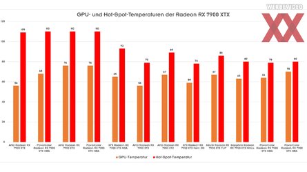

That video is from a couple of days ago and likely the reference of many of those other sites. Anyone can speculate as to the cause, but it has more meaning when there is testing done as to why it might be happening.After further testing der8auer says the same as multiple other websites It's all over the web for a couple of days ... or I'm so lucky to get spammed by twitter news from various sources.
