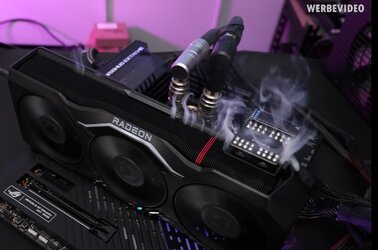

I just want to comment, cutting the cooler open doesn't give any indication as to whether there is insufficient fluid in the vapor chamber. The amount used is so small and since it's in a vacuum most of it would evaporate as soon as air enters the chamber. I don't know about the lack of sintering on most of the posts and the presence over the GPU, maybe the idea is to collect liquid from the whole chamber to then bring it back across to the GPU in that location. Or is the sintering only necessary because the depth of the chamber is larger there. These are things I have no clue about.

The orientation thing can happen with heatpipes as well as vapor chambers, did they not put the thing in a case to test it horizontally? If so what a huge oversite!
