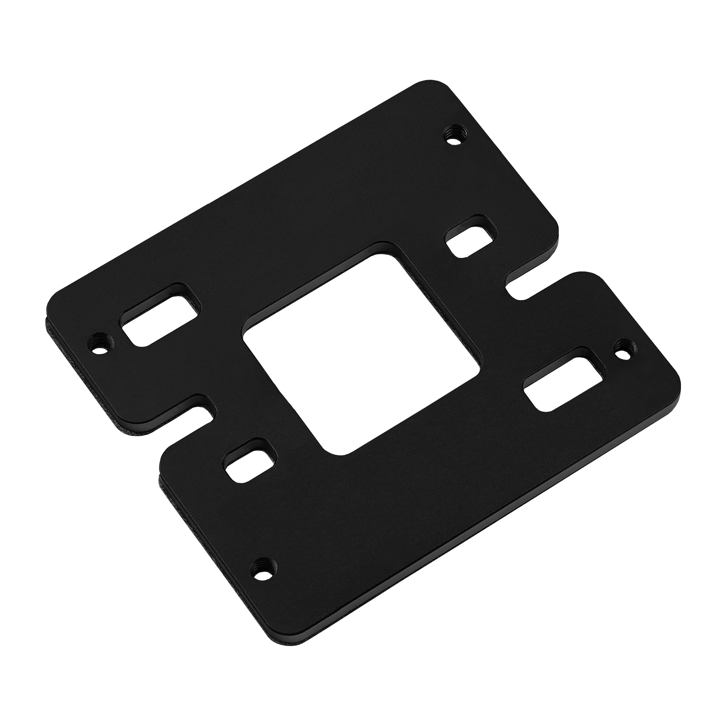

I'm going to do the direct-die cooling. Anyone have any personal experience here? Seems like a pretty straight forward process with the Thermal Grizzly tools and WB.
I'm going to use the Kyro-sheets to lower the amount of times I should have to open this system up. I'm hoping to tune this guy in and then have it sit for a long time.
Cooling List so far:
The only problem with direct die installation is that you have literally only a few cooling options. Noctua offers air cooling with their direct die kit, and there is a TG direct die block. Everything else is more like good luck, and maybe it will work.
X3D CPUs don't need water cooling, and direct die installation is a waste of money. You can still do that "for fun," but don't expect spectacular results compared to regular AIO cooling.
I am very curious of what other's will be posting with the 9800x3Ds. Maybe the direct die isn't needed.
