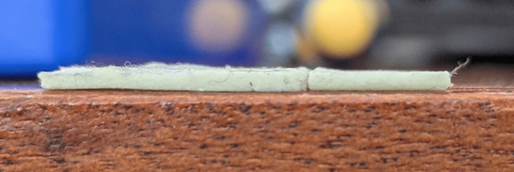

This is me trying to compare the VRM pad (left) to the ram pad (right). Looks and feels about the same. Maybe the left one is slightly fatter, but hard to tell from looking.

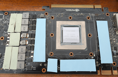

This is what I ended up doing, with original pads over VRM (left) and new 1.0mm pads over ram (right). I was too lazy to cut them for each chip and since I have plenty spare I just made strips.

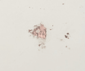

Also this is the heatsink contact area. On the left is what I saw after cleaning off the old paste. The grey lump to the right is very hard. I couldn't shift it with my fingernail. It felt too thick to be left there as it was obviously not flat to the rest. Using a flat screwdriver I poked at it and it crumbled off with some force. I don't think I added new scratches to the area, but there is copper showing there now. Did it oxidise somehow? The smaller dark areas were other much smaller areas that were similar.

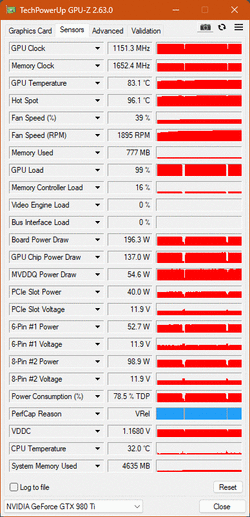

And the stats before and after. Both running PrimeGrid GFN17 for some time.

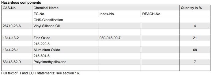

That link doesn't work for me. Amazon tries to be smart and does redirections and other things so don't assume someone in another region will see what you see. In this case, it didn't get that far and all I get is a blank screen. However from the URL I can see you tried to link to Thermal Grizzly Putty Advance. I'll have to admit I didn't know this existed and seems like it would do the job, even if it means giving Der8auer money. I see there is Basic/Advanced/Pro and I have to know the difference between them first!
TG Putty Basic with medium thermal conductivity
TG Putty Advance with good thermal conductivity
TG Putty Pro with excellent thermal conductivity
