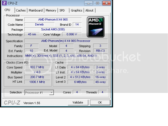

at idle Vcore is between 0.9 and 1.0

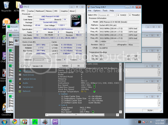

After backing the voltage as low as I could go without changing it in the bios, I set all the fans to 100% and max cpu temp of 60c and this is the result I got.
