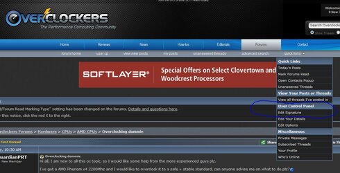

BTW - It would really help if you went to UserCP (at top of page) and added your system to your sig (CPU, heatsink, board, RAM, video, PSU). At his point it's quite a trip to the first post to see what we're dealing with here ... ;)
Yes, please put your system info in a "Sig". That is very helpful as the strings get long so we don't have to keep referring back to an early post. Include things such as: Make and model of CPU, motherboard, make and model, amount of memroy, make and model of CPU cooler, Make and model of case and # of fans, Operatiing system. Room temp is also a helpful peace of info.
Updated my sig.
