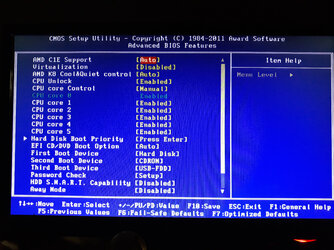

I am trying to overclock my AMD Phenom II X6 1070T (it says 1075T in some programs) I never tried to do it with this processor and I had never set its clock speed ...
I have noticed that the clock multiplier never goes higher than 11.5!
This is really crazy, on the MOBO the clock multiplier is at 15, as originally brought.
I have tried fiddling all the parameters, managed to raise the FSB to 240Mhz, ¨overlock the AMD¨to 2800Mhz, but I cannot raise the clock multiplier more than 11.5
If I can lower it to 10, 9, 8 but never go higher than 11.5
Does anyone have any idea what I should configure?
This is the first time this has happened to me.

No such thing as a 1070T. It is a 1075T. It is because you have CPU Unlock enabled. Disable it.
There is nothing to unlock on that chip.
Update your bios. There are at least 2 newer than you're running.
Turn off core boost.
Turn off C&Q.
Turn off turbo core boost. I think you were confusing unlocking disabled cores with unlocking the multiplier. All the cores are enabled on that CPU. from the factory. A lot of people have been confused this way.
Thank you very much for your help!
I already managed to do a simple OC!
Greetings and thanks again!
