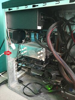

Anyone, I assume I still should get a case fan is that correct? Is this the one to get:https://www.amazon.com/dp/B00NEMG62M?tag=pcbuilds101-20
No, if a 140mm will go where I have the red arrow, put 1 there, if 140mm is too big then a 120mm. Also, try and neaten up those cables too.

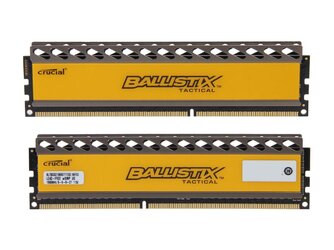

Also, I found a very similar thread on this same forum but back 4 years ago. It looked like several posters had a similar issue with lockups and they all has ASUS mb but Intel CPU. One poster asked what kind of ram and the guy have the problem stated 'Crucial Ballitix Sport DDR4 2400mhz'. I also have Crucial Ballistix although DDR3 Tactical as mentioned earlier. The other poster responded "One guy on the ROG forums had the same RAM as you (I see it uses all chips :s), swapped it for G. Skill, no problems after. I had Corsair (uses Hynix chips), swapped it for G. Skill (using Samsung chips) not experiencing any problems for now (for a week, since I put it in). My guess is that the Hynix chips are not compatible somehow. To cut the long story short, swap your RAM with G. Skill, nothing else seems to work."
I don't know could it be my ram sticks that are causing the issue?

I would also change that cooler orientation 90 degrees, to blow front to back.
So just to be 100% sure, since I'm not sure about the air flow direction, would I make it so the cooler fan would face the front of the case?
trents
Senior Member
Dec 27, 2008
Case air flow should be from front/low to rear high. The cooler fan should be blowing air through the cooler from front to back towards the rear panel case fan. Computer fans are made to push air from the open side of the fan frame through the spoked side.
