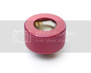

The Primochill and Modsmart Box arrived but a few parts where missing, namely the custom fittings for the acrylic tubing, meaning we can't move forward until its resolved. With the deadline creeping up and so much left to do the timing couldn't be worse:eek:
We even contacted various UK suppliers in attempt to buy them ourselves just to get things underway. Sadly the UK suppliers have the same info as us( their on order). The new range of products Primochill has released, has had such a strong response. they can't get the bits out to the resellers quick enough.
Which in their defense we understand, We don't understand why an incomplete pack would be sent though.:confused:

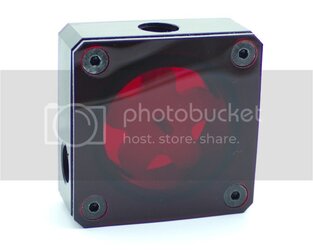

Flow Indicator
Reservoir

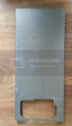

We've been a little busy but yesterday connor mocked up his templates for the sheet metal work. we've just got back from fabrication and they turned out great.
The first peice is a simple L shaped PSU box
You'll notice a cut out, We didn't want the PSU that Cooler Master sponsored to be hiden, The cut out will show this part marked in red
