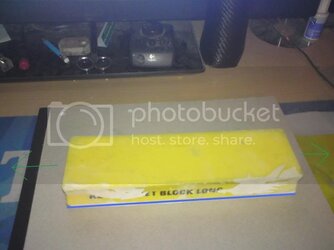

15: - Using a sanding block
This is photo shows the way most people use a sand block when flatting out paint work or filler but this is not the best way of doing it as I will try to explain in a second.
The green arrows show direction the sand block is moving in and the blue line show the edge contact.
Now using a sand block like this would be fine if you can keep even pressure on both side of the block as if the pressure is a little uneven one tends to dig in to the surface and leave a low spot while the other side of the block dose little to no work but in the photo below ill show you the best way to use the sanding block to minimize this.

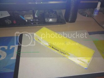

Now as we can using the block in the same direction (green arrows show direction the block is moving) but at a 45 degree angle which as you can also see from the contact patch of the edges is reduced (blue lines show outer edge contact patch) meaning even if the pressure on the block is not even your less likely to end up with one of the outer edges making a low spot.
Sanding blocks also come in all shapes and sizes and some flex a little more than others do. If you’re going to be doing your pc case you’re not going to need a very large block but you might want one with a little bit of flex to it.
