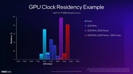

Since we're here, this is one of the slides on overclocking. Looks like you get hands on with:
Frequency offset
Power limit
Voltage limit
Temperature limit
Manual curve adjustment in advanced settings.
From the chart above it looks like clock offset gets you so far, presumably because you'll hit power limit more often. 2800 to 2950-ish for a +200 offset. Increasing power limit 20% gets you to 3050-ish. Further increasing the voltage limit to 3150. All considered, 12.5% uplift from stock.
One minor point of concern here: this is a nominally 190W part. TPU shows the LE has a single 8 pin power connector, for a nominal 225W total max. 190W + 20% is 228W. I think if anyone really wanted to OC one of these, maybe look for AIB cards with more power connectors.
Live a little...lol. That particular power limit won't let it be a problem. If there are others with a higher limit, I'd expect to see it (additional power connector) though.
Was it the RX 480 or 580 that released taking excess power from the slot? Raptor Lake is still fresh in mind... basically I'm saying, even for OC a little margin might not be a bad thing to have. Especially the slot power is split across several different voltage rails.
