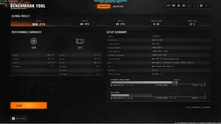

I just swapped out a 8700G cpu in a rig that may be sold. I replaced the cpu with a 7700X to up the performance a tad. The original gpu was a RX 5700 XT, but it would struggle in some games. Replaced the gpu with a RX 6800 XT and it performs light years better. My question is about interpreting data shown in the COD 6 benchmark. It was run in the Extreme preset...can anyone tell from the screenshot if there are any evident problems? Probably selling this rig and don't want any problems for the customer. Thanks for any help in advance.

Hard to compare when we don't see the 8700g.
But it looks like it's saying with a faster processor you could gain something at that res. How it measures, no clue. But id agree... im sure there's a bit left on the table considering there are faster cpus out. I'd guess that 93% value goes up when you raise the res. ;)

No, what I am trying to say is I don't know what those "bottleneck" or other figures mean. Or are they meaningless without something to compare to? The rig now benchmarks and games like a beast with the new components compared to the 8700G/5700XT that were previously in place. I have never spent much time messing with gpu's, overclocking and such and likely never will. I simply have just always bought a card for gaming that I thought was reasonably assured to be powerful enough for the current games. In other words, I am clueless about the vernacular lol.

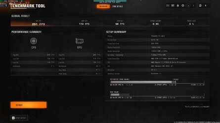

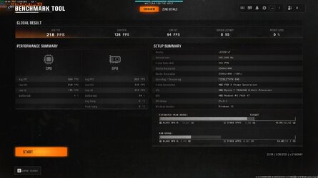

I'm guessing all is well regardless. I just repeated the benchmark on my dedicated gamer (7800X3D/7900 XT) in both 1080 and 1440 resolutions and in general it acts the same. My conclusion is the 7700x/6800XT combo is no slug for gaming to the best of my knowledge.

The benchmark appears to be showing you how much of the time where either the CPU is the limiting factor, or the GPU is. Other benchmarks call it "CPU limited" or "GPU limited". If you increase the performance of whatever is the bigger limit you should see gains. As you show, the balance is affected by settings as well as the hardware. At lower resolutions where you can attain higher fps, the CPU plays a bigger part. At higher resolutions/settings the GPU tends to do more so CPU matters less.

In the screenshots, a lower % means the CPU/GPU causes less bottlenecking. So at 1080p, it shows that the FPS is bottlenecked more by the CPU, at 1440p more by GPU. This is expected as mackerel already mentioned.

Yeah, it's simply showing where the bottleneck lay for those settings. 1080p is notoriously CPU-bound so you'd typically see some sort of CPU limits there, especially with faster cards. As you increased resolution, the 'bottleneck' moves to the GPU (which is where you want it to be, ideally). If you dropped in a X3D chip from 7/9 series or even a 9 series CPU, the CPU bottleneck will likely shrink at 1080p as it can output more of what the GPU can send it. ;)

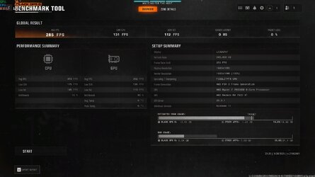

Just for giggles I installed the RX 6800 XT in the daily with the 8700G and ran the benchmark at both resolutions. In general the 7700X was a great improvement, but the 8700G proved to be more than capable. Just as before on Extreme preset. There's that damn white space again lol.

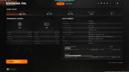

Just ran it on the 780M cpu graphics. Not really playable lol. Finally figured out how to close up that white space. :LOL:
