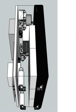

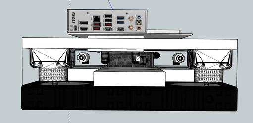

Here are some SketchUp drafts:

Build Basics:
  • 1260mm (9x140) radiator
  • ~100mm gap between radiator and wooden front panel
  • mATX back-connect motherboard with a 9800X3D and Bitspower Summit Revo CPU block
  • AMD 7900XTX with Bitspower GPU block
Both visible components have their tube fittings at the back of the wooden front panel. The gap between the front panel and radiator will be closed off with magnetic attachments and ventilation grills. Still figuring out the base, as all the I/O cables need to be routed cleanly.
Fans, pumps, PSU, cables, tubes, and controllers will all be tucked into this hidden section. The design allows the radiator and front panel to be easily detached, thanks to quick disconnects on the tubes.
I’m still debating whether this unit will sit on a large pedestal or be wall-mounted—both have their appeal.

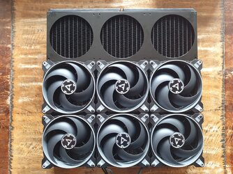

This is the monster radiator with six planned fans. That leaves three unused fan slots—one for mounting the power supply and two for the pumps, which will likely be attached to the wooden panel. I’m still considering 3D-printing custom mounts to attach the pumps directly to the radiator instead.
Some fan mounting holes are left open deliberately, because they'll serve for the stand-off between the radiator and wooden front panel I've come up with.

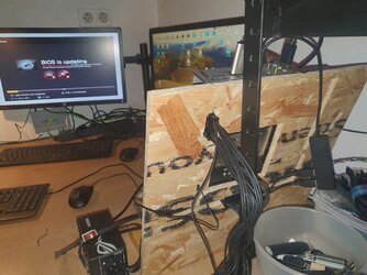

Behind the scenes I'm working on a mock-up version of the actual build, before I would even consider using proper hard wood. For now I'm using a piece of OSB, which is sawn out based on a print I made of the product photo of the backside of the motherboard; and it actually worked out!
To really get those jank vibes, here's the backside:
Now, I've been advised by a few people who actually know wood, that a centimeter thick wood will probably not withstand the heat sources I'm planning, even if it's proper hard wood. So, the current consideration is to use two centimeters thick hard wood, with perhaps some reinforcements on the invisible backside. I won't yet give away which wood I'm planning to use, but it's gun' be funky!
Another consideration is how to mount the radiator to the wooden plate in a durable way, as either side could produce quite a bit of pull when they're not in foot mount. So, I'm hoping to construe a proper but disjoinable connection between both sides, perhaps with a diagonal thin metal plate, and a proper but optional foot to make sure my cats won't just trip it over. I'd like this system to be durable, and have the option to upgrade parts at a later stage.

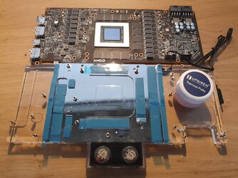

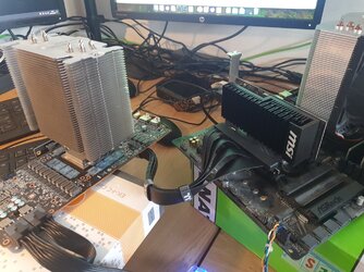

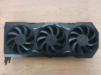

First, I'm working with the AMD reference 7900XTX. The maximum power consumption is around 450W when you crank up the +15% power slider in Adrenaline. Today, I flashed the ASRock Aqua OC BIOS onto this card. It took some effort, but the reward is significant—about 200W of extra overclocking headroom, pushing power consumption to around 650W. For comparison, the reference model has a core clock boost of 2500MHz, while the Aqua OC reaches 2935MHz! Decent cooling is a must, but that won’t be an issue. 😉
The CH341A USB programmer with 1.8V support arrived this week, so I took the smallest crowbar in the shed, and cranked this bad boy open. Using AsProgrammer, you can read a BIOS chip and compare it with a downloaded AMD 7900XTX reference BIOS. If everything checks out, you know the clip is properly attached, and you’re good to write. In this case, an ASRock Aqua (non-OC) BIOS had to be flashed first.
NSFW, naked GPU alert!
After that, you can use an .exe tool within Windows to upgrade from the Aqua to the Aqua OC BIOS.
A quick GPU-Z test to make sure the card still works (phew), and then the waterblock can be installed. I took out the RGB-strip from the CPU and GPU block, because in the end the build will have splashing colours, but not because of some standard (and in my opinion boring) RGB LEDs. Also, the cables are in the way.
Since this card is meant to go brrrr, I’m not using the standard thermal pads (blue strips) that come with the water block, but UTP-8, which has better thermal conductivity. Additionally, the core is getting non-conductive PTM7950, which is the best option right after liquid metal. Liquid metal is tricky to apply, can eat into other metals, and has a risk of dripping out if you put too much. This thermal pad needs a few heat cycles (above 60°C, if I recall correctly), so I ran a few dry FurMark tests to break it in. Toasty!

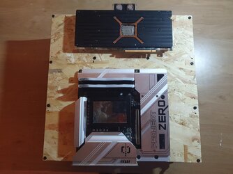

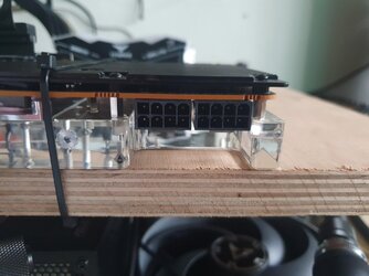

And, without you even realizing it, I also worked on some spacers and continued with the OSB board. I probably should've used plywood from the start, but we're still in the mock-up phase and far from the final design! After reviewing the sketch again, I think I can shave off about 1cm thickness!
Below is the current setup but, in the final setup, the top plate will be flipped 180 degrees so that both the GPU fittings and radiator fittings are at the top. I'm considering flipping the whole thing upside down, with the PSU and pumps are at the bottom for better weight distribution.
Ideally, I’d like to have GPU backplate facing front, and using the typical acrylic front to mount the card onto the wooden board while keeping the backplate ventilated. It's also just better for aesthetics. The downside is that I haven’t found a PCIe extender that fits properly. I did manage to get my hands on the following cable, but it’s not an ideal fit. If anyone has suggestions or happens to be working on wireless PCI-E magic, let me know!
This is starting to resemble the sketch, right?
Above you also can see the CPU block installed. It doesn't look like much, but I plan to do some work on it in the future, as well as on the rest of the motherboard heatsinks.

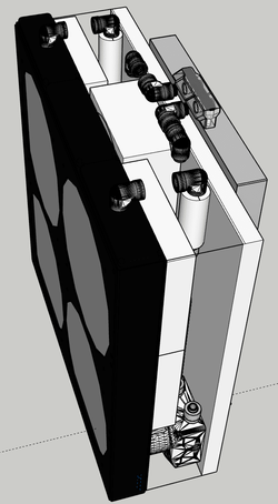

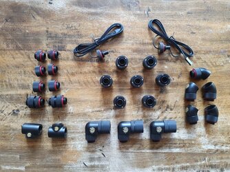

Some fittings are still on the way that will allow for a few very tight bends. This is necessary because I came up with a new layout that's a bit less top-heavy and should be more stable when the system is placed in a pedestal. For the wall-mount option it wouldn't make much difference, but in this case it seems like a safer bet.
The new layout, with a 20mm thick front plate:
The GPU fittings stick out above the front plate, which nicely aligns with the fittings that already come out of the radiator.
Here you can see the power supply placed at the top, and that many more angled fittings are needed than originally planned. Both the CPU and GPU blocks have a specific flow direction to consider. Luckily, the CPU block is reversible, while I want the GPU to face forward with the backplate, which brings more complications than just the flow direction (more on that later).
The GPU block uses what's called an impingement design (directional design). It basically means water is pushed through a single channel right into the middle of the fins on the core, and then spread out through the fins. Fun fact: having the In/Out reversed can easily result in a 2-5 degree temperature penalty, so I'd rather deal with some wild tubing than sacrifice performance, right?
The bottom part, which will also be neatly enclosed, with an opening toward the I/O panel. You can see the two pumps here. The whole loop design could’ve been much simpler with just one pump, but as everyone knows: more pump, more better! — Seriously though, two pumps can run at lower speeds together, so they should be quieter, and if one fails, your whole system isn’t instantly wrecked. For a single GPU, CPU, and a decent radiator, one D5 would normally be plenty.

I got the idea to recess the GPU slightly into the wood — maybe the full depth of the acrylic, but that might cause wood warping, so I’m thinking just 5mm to hide the (industrial Velcro) mounting would be a better idea. I still need to test how flexible the PSU cables are, or if I’ll need 90-degree connectors on the 8-pin plugs. From what I understand, those connectors can also cause coil whine, and even the cable length (shorter or longer) might have an impact. For a silent build, coil whine is the last sound you want to deal with.

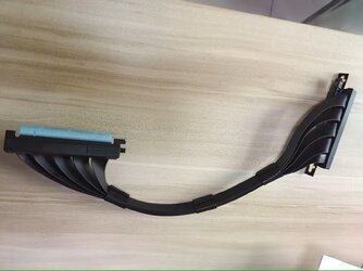

In my last post, I mentioned how hard it was to find the right PCI-E 4.0 16x extender — and that’s still true! They basically don’t exist. Or… do they? Yep! I’ll soon have the only one with the exact right proportions, thanks to the maker of the same cable shown in the previous post. I pitched my needs to a bunch of Alibaba vendors — 50% didn’t get it, 40% tried to sell me a different product, and 10% actually understood the problem and request. Luckily, one of them turned out to be the same manufacturer who makes the cables for TT and was willing to make a custom model, hoping it might lead to future sales. My idea is to eventually offer this case concept in a more finished form, and then that cable will be essential.
