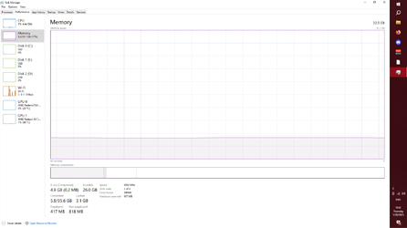

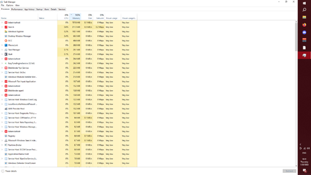

What is taking up all of that ram (see task manager... post a picture of your processes that show ram use (sort by most up top).

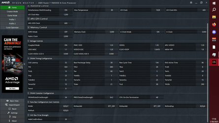

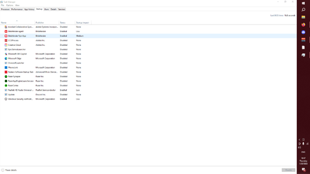

Okay, so here's some "fresh" boot snapshots of the Ryzen Master program and Task Manager. It completely slipped my mind to get these as soon as I got home from work. The only programs that were actively running for about the hour and a half that it took me to remember getting these snapshot were a tab of Firefox, BitDefender, and Discord.
As for the excessive RAM utilization, it more than likely have been from Steam I had set as a start up program and immediately downloading game updates; Discord as a start up program and doing discord things; and BitDefender doing its scheduled full scan for malware on boot up.
As for the "undervolt" that I may have incorrectly categorized, I read it from the gauges at the top of the Ryzen Master program. PPT was showing "(negative)- --% of 350w" CPU Telemetry was showing "0.947 V" and SOC telemetry showing "1.045 V". The window itself also froze and I could not scroll down and check the status of the read outs on the Ryzen program labeled as PG 2 in the attachments. This is what I remember from Wednesday night before everything froze and Ryzen Master crashed.
These snapshots were taken using only 2 of the 16GB Flare X5s
Okay, so here's some "fresh" boot snapshots of the Ryzen Master program and Task Manager. It completely slipped my mind to get these as soon as I got home from work. The only programs that actively running for about the hour and a half that it took me to remember getting these snapshot were a tab of Firefox, BitDefender, and Discord.

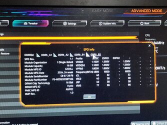

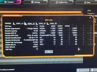

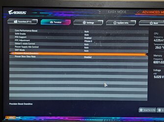

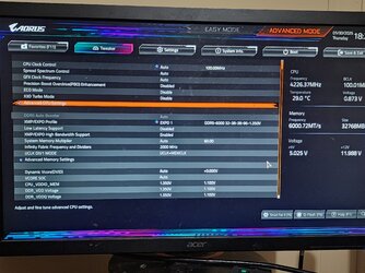

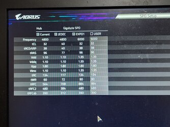

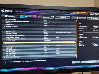

And the current BIOS settings snapshots.
Did Ryzen master crash or the whole thing? To me it looks like you have them running at 6000, but maybe not stable? However if you're also tweaking things in Ryzen master it is difficult to know what is causing your instability. I'm a few generations behind but the situation you're describing with PPT does not seem to be RAM related at least on the surface.
With just expo set in the bios and all four sticks installed, is the system stable?
A lot of overclocking is not set it and forget it, although EXPO is an attempt at this, its important to remember that it's not just the RAM but also the memory controller (which while located on the physical CPU, is not part of the core and is actually on a separate piece of silicone and not to my knowledge a significant component of PPT, or the chip's power draw) that has to operate beyond spec. Double the memory sticks is double the work for the controller. I would check your temperatures as a sudden drop in power is more consistent with a thermal problem in my experience.

When I was able to get it to run with all four sticks, EXPO would not stay active. Any time I tried to activate EXPO with the four sticks, the BIOS Screen would have a pop-up on boot up saying the auto settings are unstable. The only options I get are to revert to a stable setting and boot through, revert to a stable setting then reboot. or enter BIOS.
Cirrently the only thing I have tried to tweak anywhere near in-depth has been the VDDQ, VDD, and VPP voltage settings from "Auto" to "1.350 V". I have not gone into the Advanced Memory setting to mess with the individual clock settings as of yet.
