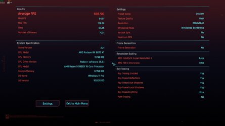

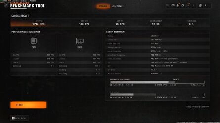

I don't have the 7800X3D rig up and running at the moment to compare, but here are some game benchmarks with the 9950X cpu. Maybe someone can point out any problems. (COD 6 and CyberPunk 2077)

Don't need any benchmark help. Those were provided so the OP could make a informed decision on the actual benefit of a X3D cpu or not.
Oh, sorry. I misunderstood. Are there X3D results to compare to as well? It's been a long thread.

I don't have the 7800X3D rig up and running atm to compare...just reporting what many online have said when gaming at 1440p and above. I'm sure there are some members here that can confirm or deny. Since I use 1440p that is likely the reason I never saw any real differences/gains when gaming between any of my cpu's even when using the same gpu.

Oh, Ok. Here's some testing @ 1440p...5% difference across their 20+ games. You should've seen something in yours at 1440p.
... that said, I decided to go with an X3D even at 4K. For me, and my 240Hz monitor, every FPS counts... even if that difference shrinks to 4% (where at 1080p it's 8%). If that doesn't matter, I'd go non-X3D too and throw that money towards something else.
