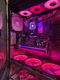

Also, I wanted to get a vertical gpu mount. Does anyone know or have used the PHANTEKS GPUKT 4.0 ARGB? I like that you can actually angle the GPU with it, and the RGB is pretty subtle.
i have one... and while it IS in a Phanteks case.... all you need is 7 expansion slots... (technically 6, but the top needs about an extra 1/2 a slot, so i say 7) and enough room for the card (and GPU) of course... it has 3 screws to mount to the case... and 3 screws available for the GPU.
However... with it angled, the 40x0 and 50x0 cards will be awfully close to the motherboard near the RAM due to the extra width.
My bracket is in slots 2-8, but i have 2 more slots below the bracket i could play with when i get a bigger GPU
