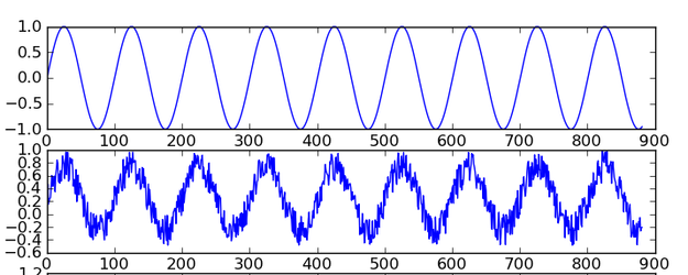

Noise and spikes on the various voltage rails of the power supply are not heard by the human ear. They are seen on a scope as odd crap on the predominent voltage waveform.
The less odd crap within a particular voltage output, the 'cleaner' and better it is for use in DC circuit.

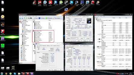

Lightsome, how about attaching some captured images of CPU-z tabs: CPU, Memory and SPD. That will give us a load of information about your bios settings and your hardware. Crop and save images with Snipping Tool in Windows Accessories then click on the Go Advanced button at the bottom of any new post window. When the advanced post window appears, click on the little paperclip tool at the top. Rest is obvious.

CPU Tab in CPUz from CPUID com
attachment.php
Memory Tab in CPUz from CPUID com
attachment.php
SPD Tab in CPUz from CPUID com
attachment.php

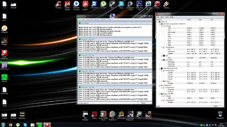

And this is screen capture of HWMonitor (free version) from CPUID com
HWMonitor has been scrolled enough and large enough to show Min/Max of Voltages and includes the CPU Core Temps; which are n0w called Package Temps, fully visible.
This capture is made of HWMonitor after it has been open on the desktop logging Min/Max temps and voltages while Prime 95 was running Blend Mode test on all cores for at least 20 mins and then the capture of HWMonitor was made and it shows the Min/Max temps and voltages before P95 Blend was started and while running P95 Blend mode and gives much greater insight into how the system is performing without guessing.

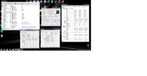

Ok, here are the pictures with everything at stock.
Normal. Without Prime.

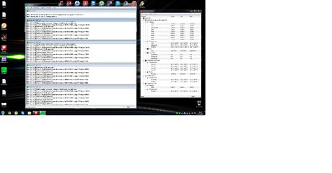

After Prime. With same settings.

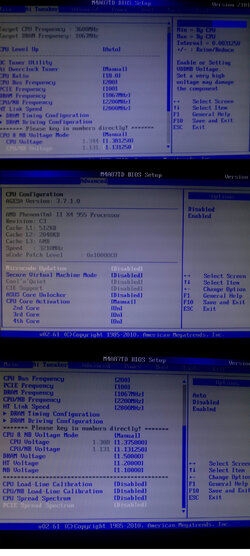

I will show you some screenshots including BIOS.
From bottom to top are newer settings.
Also in the middle cpu configuration area, what does the Micro code updation and Secure virtual machine mode mean? Should they be disabled?
NOW, everything before Prime test. (Switching between CPU/NB voltage 1,125v and 1,131v. Don't know which is better for now.)

HAH.... at 3,6ghz with the settings you see in the 2nd picture where I highlighted the area in red.... with just Chrome and Photoshop opened MY PC CRASHED -__- . But why ? I made a lot of tests and pc handled running both at the same time Prime Blend test (torture mode) and 3Dmark test, still why it crashed with just chrome and Photoshop opened ?? Same 124 error LOL. DRAM 1,6v doesn't help :/ also tried 800mhz but no luck.
