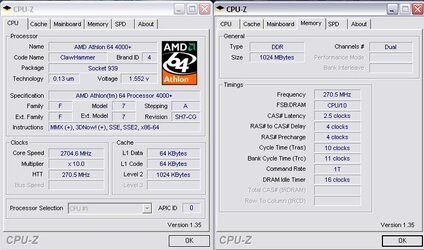

Its wierd tho as i can get my CPU to 2.7 with a 12 multi but just not with the higher FSB and lower multi. Plus my PC boots up fine just will not go into XP.
I have just been reading some old 4000+ reviews and the reviewers seem to have more luck getting the FSB higher on the San Diego rather than the Clawhammer that im running.
maybe your just at its limit from what i rember a high muilti is normaly easyer for the cpu to run.. but is not as " fast " so maybe thats it.. idk tho have you tryed to give it any extra juice?
Yeah gave it 1.56v i was using 1.55v before.

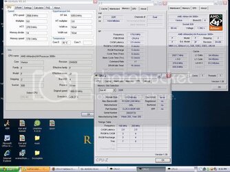

I know this is a stupid question but in CPU-Z under my memory tab the FSB:DRAM is set to CPU/12. What sets this command? Im guessings its the HTT/LDT?
I think i may have found the problem found from google searching:
"Another thing to watch out for is if you are using sata drives that they are connected to 3&4 NOT 1&2. This is because when o’clocking channels 1&2 don’t like high HTT and will crap out over 240."
OMG the above is correct, just unplugged my SATA drive and i can now magicly run 11 x 245 !!!!
Dont belive that :(
