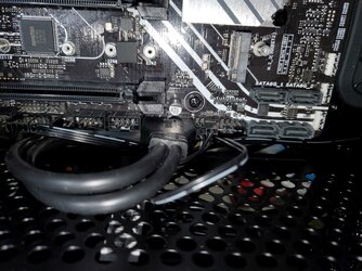

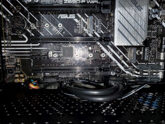

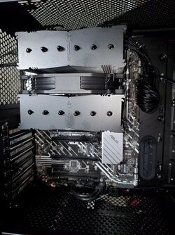

Take a picture of your PC including connections and such....
maybe a video if you can figure that out...

Let me know if you need a certain location picture

I'd like to see images of the power plugs on the mobo...the one by the CPU...
A whole shot of the mobo would be awesome...
EDIT: Which was is that fan blowing on the heatsink..hopefully UP towards the top of the chassis. I thought that would be mounted so it blows towards the rear along with a rear fan to help remove the heat... so yeah, a full mobo and case shot would be great....

Power supply has the 4 pin and 8 pin connected
3 fans connected
1 Fan for NH-D15
I NVMe installed in M.2_1 (Socket 3) ......Right below CPU.....is this correct?
Front Panel Audio connected
PWRSW, HDD_LED & Reset connected (the dotted line indicates + Correct?)

NVMe is correct.
Well, if you're able to use the power button, it's on correct, lol. The others, not sure. unplug them and see if it helps (doubtful) I never know those unless they work, lol.
Which way is that fan blowing on the heatsink..hopefully UP towards the top of the chassis. I thought that would be mounted so it blows towards the rear along with a rear fan to help remove the heat and the front fans feeding it. When you put a graphics card in, that will suck the heat right off of it.....
....so yeah, a full mobo and case shot would be great...
EDIT: Did that case come with motherboard standoffs installed or did you have to install them? You used motherboard standoffs, righT?

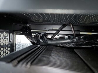

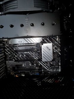

Hard to get some pix while in case....hope these work
That's a sucky question "EDIT: Did that case come with motherboard standoffs installed or did you have to install them? You used motherboard standoffs, righT?"
Edit: Sucky response was that it worries me!
I'm not sure at this point.....I know I used them on the HS but I don't think I used them on the MB....The manual does not say anything about them and if I did I don't think the rear ports would line up?
