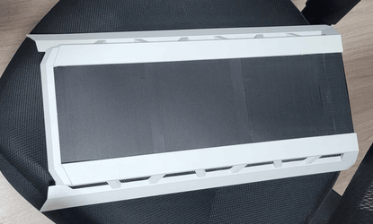

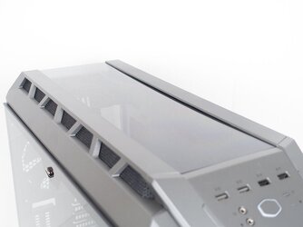

Ever since I bought this case, I always felt like it is a little underperforming and needs a few modifications. There are 2 glaring issues: The first is the top panel, which is acrylic, meaning it blocks most of the top exhaust - side mesh helps a bit, but not much. The second is the bottom fan placement with respect to the PSU shroud (see green rectangle in image below). Originally, this case was designed so that the bottom fan is used to cool HDD drivers below the PSU shroud. Nowadays SATA devices are becoming irrelevant (I personally don't have any in my PC), so it's just lost intake.
My motivation to make these changes is that since I use a passthrough GPU and an exhaust radiator on top, then a significant amount of airflow is directed bottom to top, so I was looking to enhance this airflow. and make sure I don't re-circulate hot air.

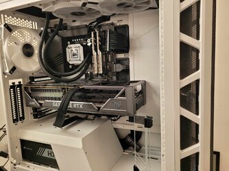

Here's what I attempted to solve this issue. What I did first was take out the acrylic top panel with a precision knife and replace it with a dust filter. Now the top panel looks like this:

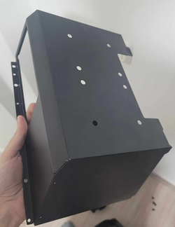

Next, I aimed at finding a more suitable PSU shroud. I bought a PSU shroud from a different case (H500M), and painted it white. It took some minor adjustments with a piler and creating a threading in the case, easy stuff overall.
And here's the final result:
As shown in the image, the case now benefits from the entirety of the bottom 200mm fan, no longer blocked by the PSU shroud, and the clearence between the 3rd GPU fan and the PSU shroud is increased significantly.

I focused on GPU thermals. One measurement with HWInfo and the other with GPU-Z (my bad), but they read off the same sensors, so it shouldn't be an issue. HWInfo was with side panel OFF, GPU-Z was with side panel ON. For both tests, I ran FireStrike Ultra Stress Test loop (20 scenes continously).
Side Panel OFF:
Side panel ON:
As you can see, less than 1c difference between "Open air" case to "Closed case" - This is a great result. Compared to stock configuration this is about ~2c difference in thermals, so on the GPU side of things, I can't call it a significant upgrade. I can't run a CPU comparison because the old panel is kinda busted.
Overall, I'm pleased with the change, and I think this case will continue serving me for years to come.
Nice mods. I would have expected a bigger change in temp than you experienced, but not much more. There was a fair amount of space below your GPU prior to the mod (looks like about 3 PCI slots) and was likely getting good air. Also, when I reviewed this case back in 2018 the addition of top fans didn't improve overall temps. Of course, that was with much much lower TDP components.
