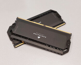

Product photos:

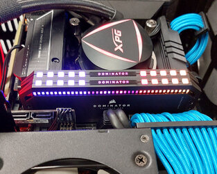

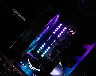

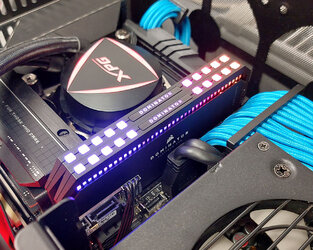

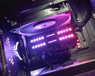

RGB works without problems. If we won't use any software then it works as a popular rainbow. These LEDs are great and I really like how Dominator Platinum RGB looks.

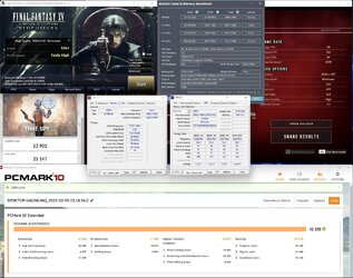

The memory kit has one XMP profile at DDR5-6200 CL36-39-39 1.30V and doesn't require any manual adjustments to work. The memory kit passed memtest built-in ASUS motherboard and AIDA64 stability test. Below is a screenshot from the AIDA64 test.

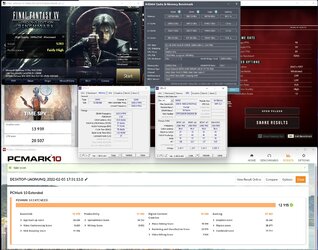

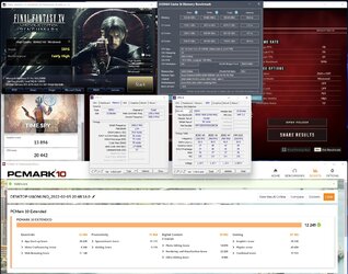

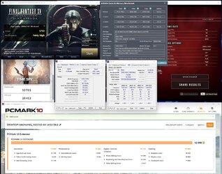

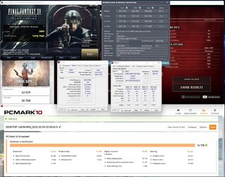

I was able to boot at DDR5-7200 but it was crashing even in the AIDA64 benchmark. DDR5-7000 is benchable at CL38 but timings aren't so great and latency is worse than at lower clocks.
The lowest CL is 26 at DDR5-6000 and results are pretty good.
As usual, fine-tuning would require more time so these are just examples of how you can set this specific memory kit.
