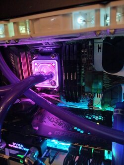

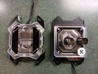

Today decided to swap the Cpu waterblocks out. I was having atrocious gaming temps and I got tired of it. Took about 3 hours total time from start to finish. And for that surprise inside the "package" (Top Rad), after draining my loop, I removed the tubing from the top rad into the cpu block inlet, and to my horror I found a small cut zip-tie quite stuck. I'm like "how the eff did this thing get in there?!" It sure as hell wasn't me. So maybe this was part of my temp problem? :shrug:
Anyways I flushed the loop, fresh distilled water, the "bleed the system dance" and fired it up. It bled quite fast, but I still have that annoying tiny bubble in the corner of the block :mad:. I'm wondering if this is the infamous bubble trapped in that dam corner.
Ok so after about an hour of gameplay, my Cpu temps did not exceed 62c. That's a staggering 18c drop from the Bykski block. Now again I can't be 100% certain the ziptie stuck in the outlet of the top rad could have played a big part in my high temps. When I first plopped the Bykski I had decent temps (68-72c max), but then over time temps kept creepin' till it hit 80c several times and I couldn't figure it out.
So the paste I used was Thermalright TF7. I was using MX4, then I tried MX6. I find that MX6 is quite runny and results were pretty crappy. I went back to MX4. I did the 4dots in corners and 1 dot in the center method.
We'll see how it does, but for now I'm happy :)

Ok then. Final results are:
With side panel off, gaming load temps are 61-63c
With side panel on, gaming load temps are 65-66c
I still shaved off 15-18c. To me an awesome win.
So if anyone is looking for a decent AM4 Cpu waterblock, I know a guy *wink wink*

So far after about an hour and a half, both rads saturated, Cpu temps levelled at 65c and Video card temps were even cooler at 55c. :clap: Don't get me wrong, the Bykski block is good, and it did give me decent enough temps, but then temps started spiking up real quick, and after reseating it several times, temps remained pretty much the same.
Still scratching my head about finding this ziptie just barely peeking out the outlet port on my top rad :eh?:

Just out of curiosity, what model of Bykski block is that?
Sorry, can't remember the exact model off the bat. I'll look it up and post it.
*Edit* Model CPU-XPH-T8-M ( I think)

Well, solid results with the new block!! Nice! I can't wait to get out of this heater...
A couple of days of doing the "bleed the system" dance, quite a bit of air bubbles finally came out and lowered my temps a couple of degrees more. I decided to remove the mosquito screen materials of the top lid and front lid of my case for better airflow. I noticed it was choking-off airflow and I was constantly washing the screens. Since I have no more pets, no need for that material.
