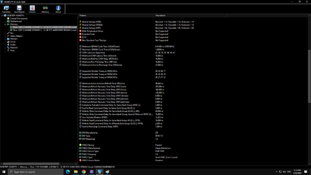

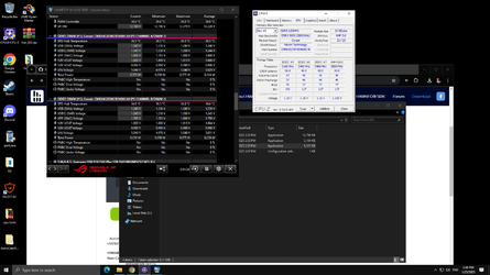

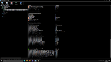

here you go @Woomack
Post magically merged:
here's hwinfo64 information of my ram as well

Since it's Micron from 2023 then you can't do much. I found some results from my older tests and I could make about 6200-6400 CL32-44-44 1.35-1.40V. It's typically not scaling well above 1.40V. You can also try 34-42-42 or 36-44-44. Sub-timings won't run much better than at auto/XMP/EXPO.
There is info that PMIC isn't unlocked, so probably it won't work at more than 1.10-1.25V. Generally it affects CL and max frequency, so if you won't make it run at CL32 or 6200+, then try CL40-44-44.

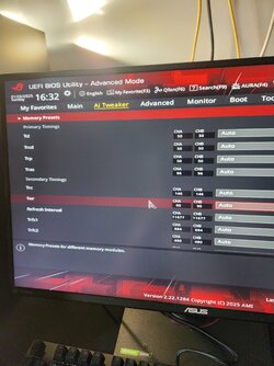

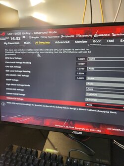

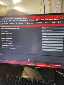

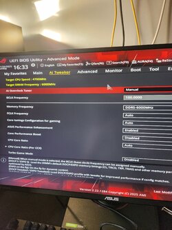

Okay @Woomack sorry for a late reply to all this, so I just went into bios and loaded optimized settings, then set the two volts we talked about to 1.40 and disabled pwr down enable and memory restore context and set uclk div1 mode to uclk=memclk and it restarted and loaded into windows. So now I'm going to try setting the timings you've suggested. If there's any last words you could give me I'd really appreciate it. Already appreciate your help from the start 🙏

Check in the hwinfo64 if it really runs at 1.40V
Set main timings - one of those I told you before or something mixed (lower or higher CL)
Run some stability tests. Bootable memtest86 is fine, but it takes a lot of time. There are some options for Windows, like even the 7Zip benchmark set to high RAM usage (~90% at least). The option is on one of the tabs. Can try Prime95, AIDA64, HCI, Y-Cruncher ... the list is long.

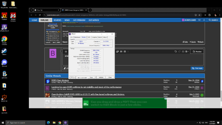

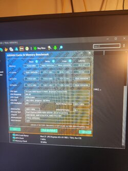

Check if it works stable, and it will be all. You can try CL36 or CL34, but I doubt you will see the difference.
@Woomack it was stable after doing multiple test these are the timings they're stable at, haven't done the other ones yet but i will try
