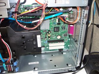

We have the 755s at my work. The motherboard is set up more like a BTX. I can take some pics tomorrow and post them.
Firestrider, here is the inside of an Optiplex 755 case looking at the motherboard:
Thanks for the picture torin3.
Yep, it looks like the standoffs are not compatible with mATX :(
well that model wont be but another might be... BTX vs mATX huge since the cpu is placed up front vs back like ATX/mATX/mITX.
even if the standoffs didnt work, why not mod the case to make it work?
