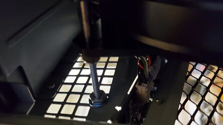

Temp mounting of the radiator. The top mount is my permanent solution. I will have to do a little modding to center it. Down below I do not want to mount it to the mesh since I don't feel it is sturdy enough for a long term solution. Plus, have those bolts showing are not aesthetically pleasing. I am using some shorter bolts as stand-offs for now. I have some aluminum that I will bend, drill and paint black to create a bottom bracket.
