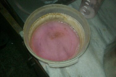

• Then i took a plastic blow fill it with water so that the copper plate can be fully submerged. Then i dropped 5-10 drops of that cleaner and got that pinkish solution as shown in pic.
• Let the copper plate sit in it for around 10-15 min. Then resin with water again.

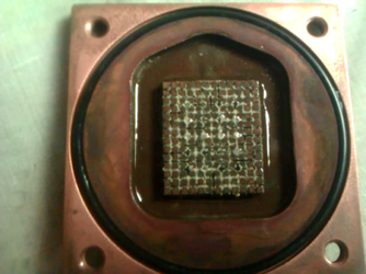

After cleaning
Its just to show before and after in detail

After cleaning
