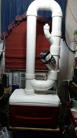

Easiest way to show that I am not just running my mouth a picture is worth a 1,000 words.
As you can see #1 was accomplished by routing the water feed line inside the right side up the return tube the intake fan is on, the branch port above the intake fan was for adding water to the cooler. The intake fan is a high speed 120mm 1.68a server fan with a speed controller to control the airflow up the cooling tube. (The server fan was overkill but I had to know for sure at what point the airflow was sufficient to achieve to cooling effect so my thoughts were since this is a test having too much that can be controlled, is better than not enough to get the job done.)
I had been researching bong cooling for years before my experiment and from one of the builders that actually performed temperature tests, he said the coldest water temperature was actually coming down the interior wall of the tube. Which totally made sense as the water falling through the air was not in contact with the air as long as the water coming down the interior tube wall. So I had an idea to increase the interior wall surface by filling the open interior with numerous smaller pipes this is located in the water spray tube below the spray head.

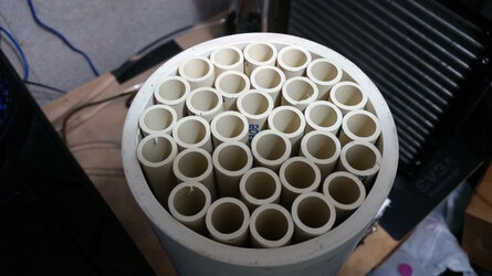

#2 Below

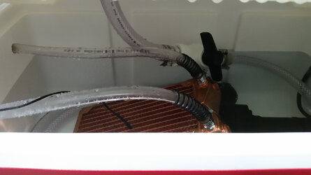

And #3 was the copper radiator used as a heat exchanger.
To clarify the failure which by the way may not be a failure to some!
My experimental tests were to replace the already functioning chilled water cooling I am running which has my coolant temperature down to 10c, 20 minutes after pushing the power button from coolant temperature that has risen to ambient.
The bong chiller using a radiator heat exchanger took way too long to drop the water temperature in the cooler with the added heat from the radiator the equilibrium point was many hours not minutes, so to me the end goal of the experiment was a failure.
