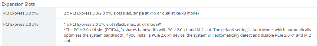

Well i feel pretty dumb now. I was doing some research to find why my m.2 speeds were so slow, and found out I'm already folding on 8x on both my cards. This would explain why I've always gotten lower speeds than most people get on their 970's. Looks like I'll be putting my 2nd 970 in my server sooner than I thought...
