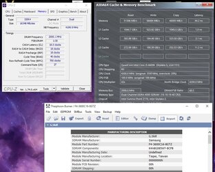

Memory is based on the latest Samsung IC also known as "B" stepping what you can actually read on the above screenshot.
Below is stability at XMP#1 profile. No issues after couple of hours.

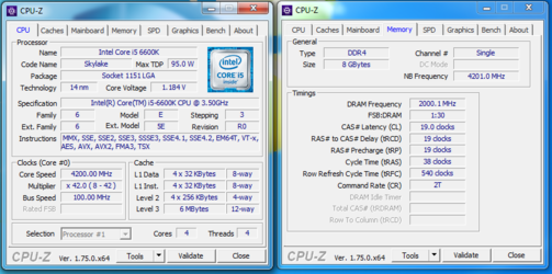

I was also able to relax timings and boot into windows in single channel mode at both 3866 and 4000 however at 4133 it would fail to post... So far no luck in getting either 3866 or 4000 to post in dual channel mode.
4000 19-19-19-38 (single channel 1.35v):

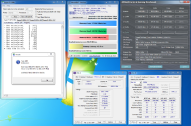

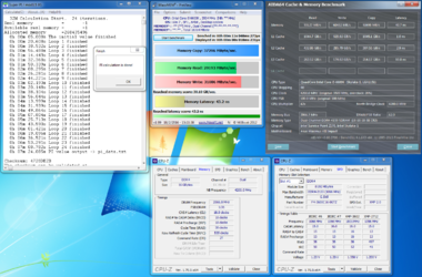

My local Micro Center store had a clearance/open-box ASUS Maximus VIII Impact available... I figured I would go ahead and try out one of these (tiny) ITX motherboards and M.C. has a 30 day return window on it to help determine if this particular sample might have any issues?
I was able to get my kit running in dual channel mode on the Impact at both 4000 and 4133! Maybe there is still some room to push these sticks a little further... :thup:
4000 17-17-17-37 (1.355v DRAM 1.200v VCCIO 1.2375v VCCSA):

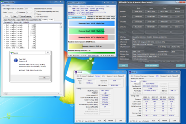

4133 18-18-18-38 (1.370v DRAM 1.225v VCCIO 1.250v VCCSA):
